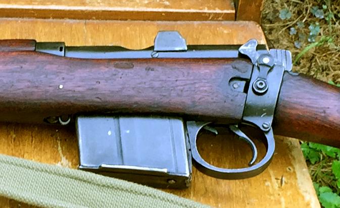

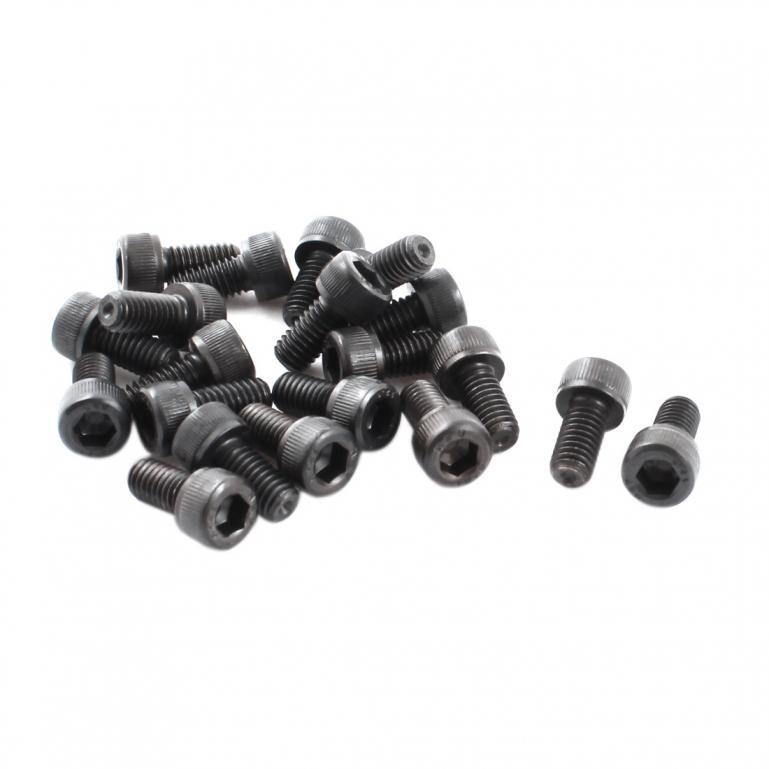

    2. My rifle had a tight safety so I looked at the diagrams and guessed that easing the safety spring screw (#10 on the Numrich diagram) would loosen it up a bit. Yea! It worked. But... I discovered that my rifle's safety screw was different from any others I've seen on the Internet. It is a hex key screw top with a knurled circumference, that looks like this:
    The finish matches the parking and wear of my rifle and the screw looks to have been there forever, but I've not seen another like it. It also appears to be metric because an SAE key is loose in it. What do you think? Field replacement? User replacement?
