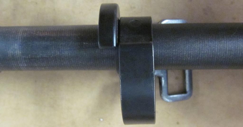

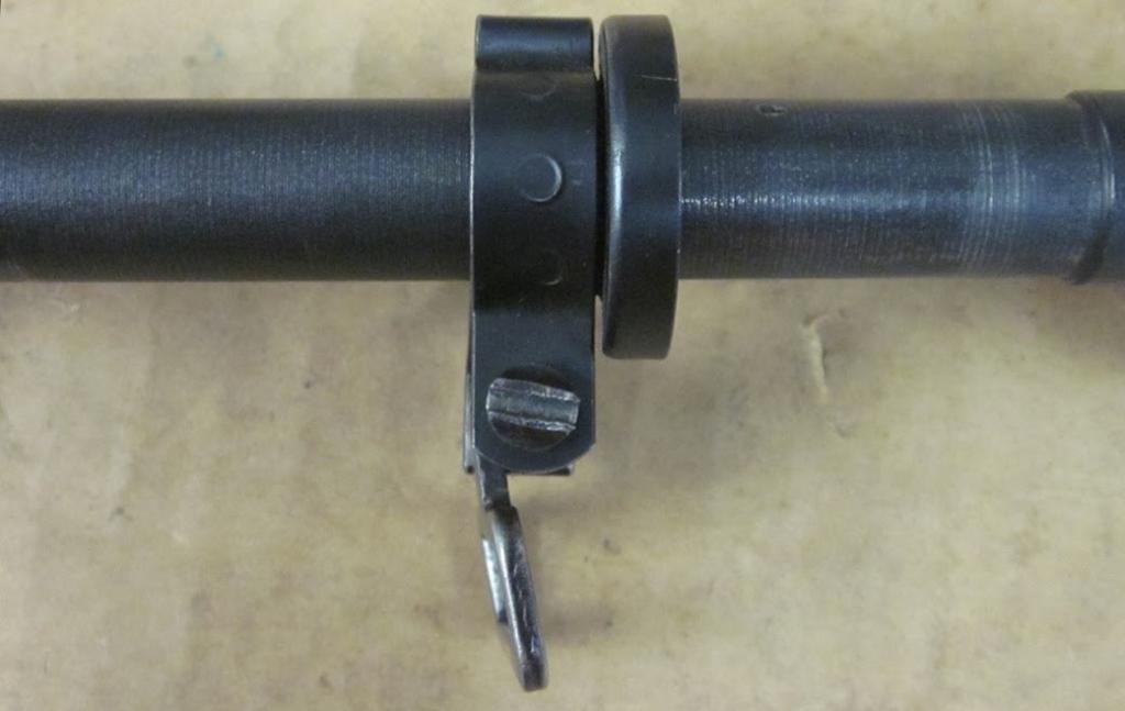

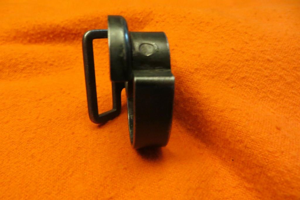

    Here's some that look better. The first one is from someone else's 226xxx Inland. The last (2) are my own Inlands.
    Charlie: Tell me with a straight face what a "straight face" is - have to do with the welds? The ones on mine are barely visible. Thanks! - Bob

    Quote Originally Posted by USGI View Post
    The shape of the Band's Front corner where the hand guard's front edge snugs up to.
    Some call it the Shoulder. I call it the face.
    Here is the one on Ebay (Which Sold) it is a Round Face:
    2 Pics Here from a S'G' 3,641,XXX is a 3 weld Square Face:
    Best I can do right now, Watching the #10 car take the Checkered Flag !
    Charlie-Painter777
    So the one (in my 3rd picture) is a "3-weld, san-serif & upside down UI, with a round face"?
    I didn't get to watch the race, but that was a surprise! Thanks! - Bob

    US GI BOB,
    Yes a Round face or Round Shoulder. Welds are hard to see, If you say 3, then there are 3.
