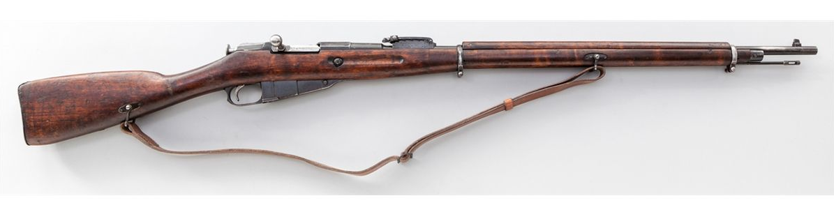

    Is this the sling setup you speak of? Also the link so you can see for a while.

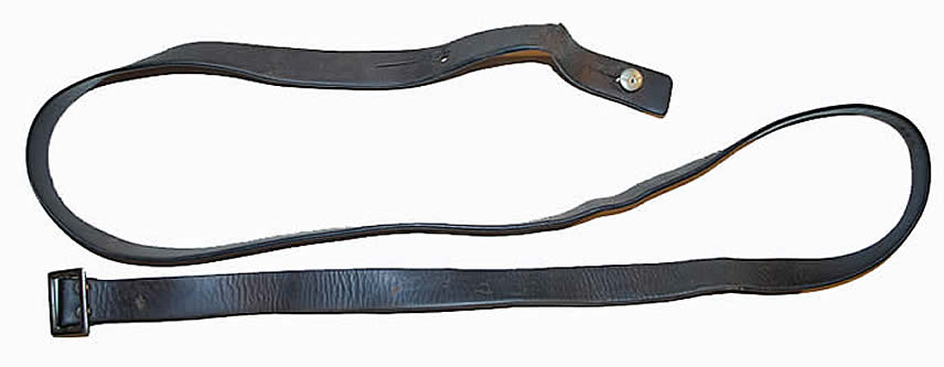

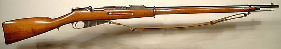

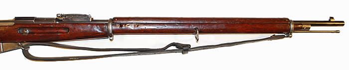

    Quote Originally Posted by 1903Collector View Post
    What was the early Imperial Russian 1891 Mosin Nagant sling that fit to the early sling swivels?
    If your talking about the pre 1908 upgrade sling set up with the magazine mounted rear sling mount and the front sling mount on the front barrel band then there are 3 types. The earliest type was canvas or leather and was sewn onto the sling loops, because you couldn't remove the sling without cutting it off few survive today outside of museums in Russiaicon. The second type is leather with a hook on one end and a leather buckle similair to Austro-Hungarianicon M1895 slings, it is also extremely rare. The third is a leather sling with a button loop on one end and a square buckle on the other, many of these survived in Finlandicon and can be found from time to time although not common. They are similar in design to the brown and green leather Mosin slings Finland used later on. Full disclosure: These pictures are from Vic Thomas's Mosinnagant.net site which is currently shut down.
    Thanks for the GREAT info. My rifle is a 1905 and has the kinda rhomboid shaped sling swivels that fed thru the brass plates in the slots located in the butt and upper handguard (did I describe that adaquately?) I had considered that the bottom loop may be sewn and attached only by removing the swivel and slipping it thru the loop. Jim sent me an image showing that exact configuration. Sarco makes a 91/30 leather sling with leather collars at the ends. If the image he sent is in fact an Imperial Sling the Sarco sling with the collars removed may be close enough, or even what was used (repro, of course)!
    It sounds like you have a Russianicon M91 that was aquired and reworked by Finland. If the picture in the post above from browningautorifleicon looks like yours then thats what you have. If that's the case then you need a Finnishicon used sling, they come in black leather, green leather and canvas. If you search on Ebay for Finnish Mosin sling you'll see examples of all three.

    It sounds like you have a Russian M91 that was aquired and reworked by Finland. If the picture in the post above from browningautorifleicon looks like yours then thats what you have. If that's the case then you need a Finnishicon used sling, they come in black leather, green leather and canvas. If you search on Ebay for Finnish Mosin sling you'll see examples of all three.
    Yes, mine is an SA marked Winter War or Continuation War capture. The crown was counterbored too (a but too deep for my tastes!) However I want it in WWI configuration for my WWI display.
    Are you saying that the wire sling swivels are NOT the early Imperial Russiaicon configuration, but rather Finn upgrades? If so...BUMMER, as I passed on others with cleaning rod, bay and a NOT cracked stock just because of the sling swivels!!! :-(
    That's correct, the sling swivels are a Finnishicon upgrade that was never used by the Imperial Russian Army in WW1. They used the standard dog collar sling arrangment or one of the earlier sling set ups as not all M91's in Russia had received the 1908 upgrades prior to the start of WW1. Finding a WW1 correct M91 will be tricky, most M91's in the US were imported from countries like Finland, Romania and Spain who used them after WW1 into WW2 and carried out their own upgrades and modifications to them along the way. You can find Finnish marked M91's that are otherwise correct with a little looking, a big percentage of the M91's in the U.S. came here by way of Finland and not all were upgraded. It's also possible to find Spanish or "Balkan" imports still in near WW1 configuration but both saw hard use so less examples exist.
