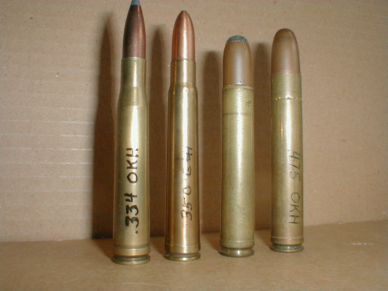

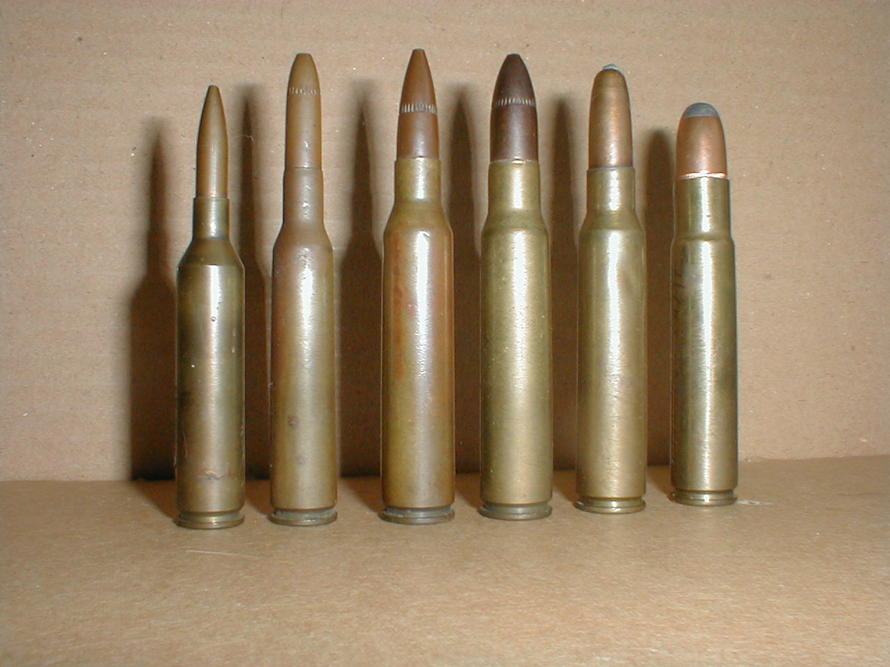

    The 8mm Remington Magnum is an excellent cartridge but never became popular, having a metric designation did not help either. The 375 H&H was being necked-down to other calibers not long after WW1, the Griffin & Howe 350 magnum in the mid 1920's was a good example.
    Then Elmer Keith and his friends started necking down the 375 H&H case to their 334 OKH which influenced the development of the 338 Winchester and 340 Weathererby.

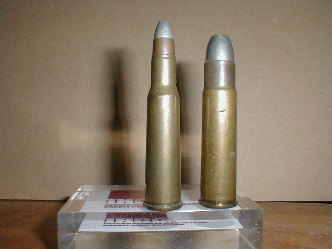

    You also had the Newton cartridges from the WW1 period, while the 30 Newton and sometimes 35 Newton had a following, the 33 Newton died.
    The 8mm Rem Mag is an excellent cartridge in the Rem 700 BDLicon just never sold well
    photos show the Newton family and some of Keith's wildcats from years ago
