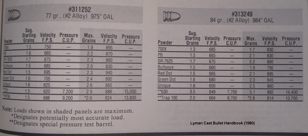

    FWIW -
Name:	32acp Lyman.gif‎

    Thank You Parashooter,
    Every bit helps.
    Greatly Appreciated,
    Charlie-Painter777
