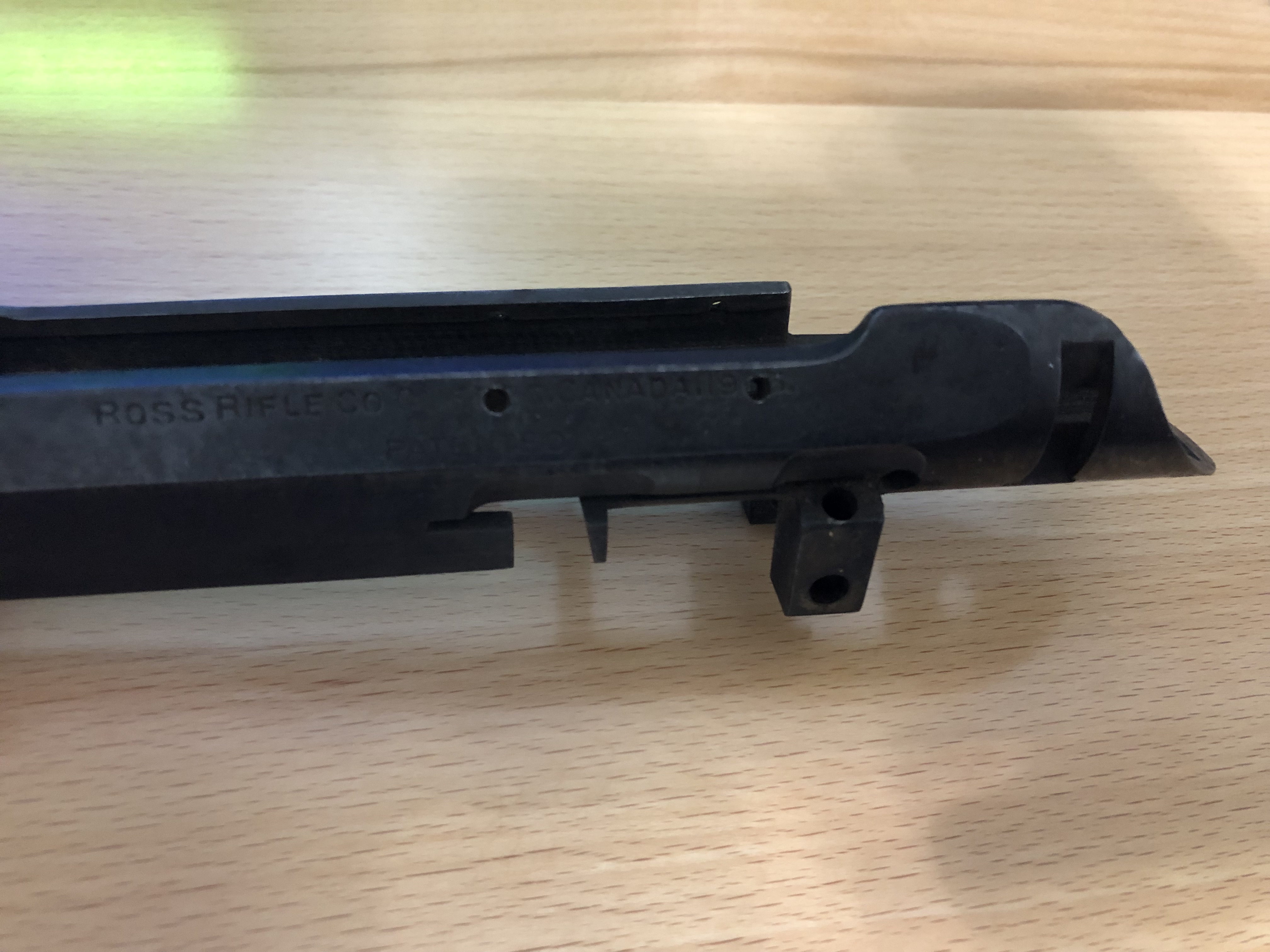

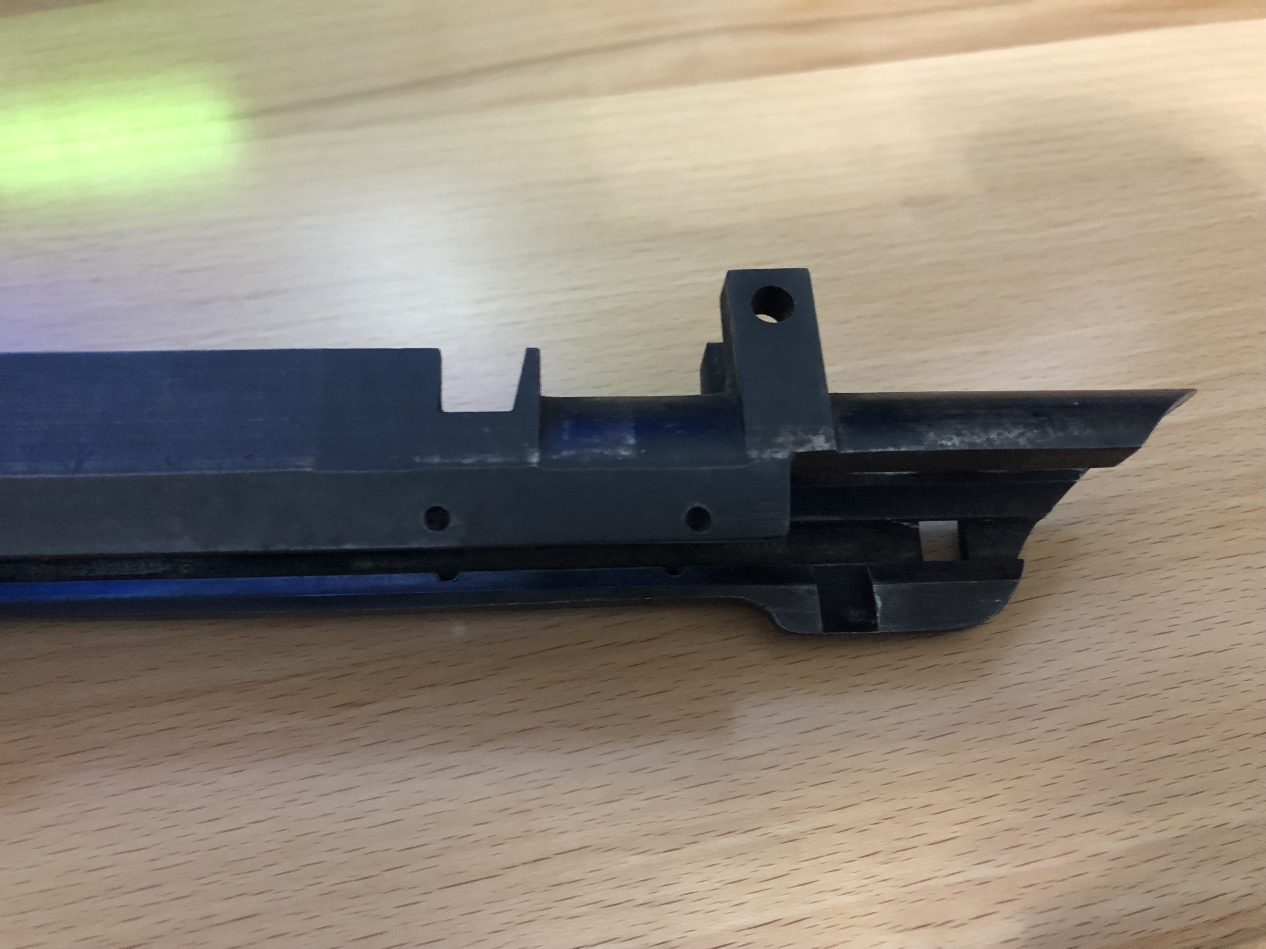

    I bought this receiver on a whim. The receiver is drilled and tapped and it looks to me that its for the bridge with Ross battle sight like the Mk II** has. I am going off example 18 on page 14 of Sir Charles Ross and His Rifle. The barrel doesn't look particularly heavier than the Mk II*** I own and appears to have formerly had a barrel mounted rear sight. This barrel was not installed in the receiver when I bought them so I suppose there is a possibility that they aren't from the same rifle. Maybe someone installed a rear bridge on a Mk II*** which seems much more common. Any way to tell?

    Looks to be a standard 1905 (Mk. II) receiver. These sometimes had aperture sights retrofitted.

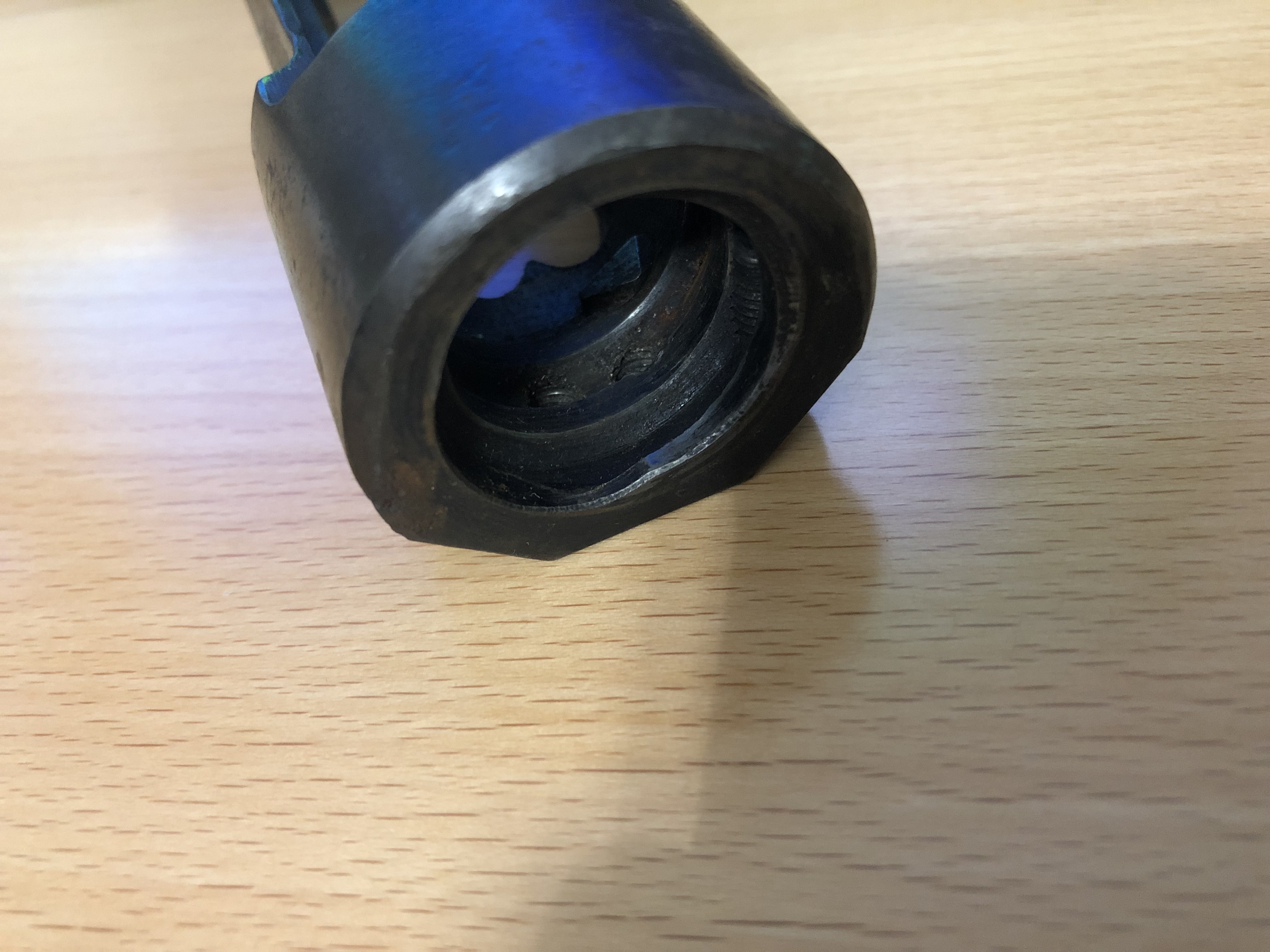

    Thanks. I thought it would be a more common model. Need to track down a bolt and I want to see if I can get a new barrel turned for it with the heavy Mk. II** profile since I found a print of one. I had been think about that before running across this receiver. Problem will be getting someone to thread it but I'm in no rush. I think what scares people away from cutting the thread is that it's a buttress thread rather than common v form thread.

    The thread configuration and left hand twist are different, but the biggest problem with cutting the thread is the very rapid twist. Many lathes just don't have the gear option. There are gunsmiths who have done the job.
    An option is to turn a scrap barrel shank into a bushing, and fit a new barrel to that.
    If you want to make a custom target style Ross, the easiest approach is to use a 1910(Mk.III) action. Those threads are right hand square. Rebarreling is akin to doing a P'14.
    Badly bubba'd rifles are common enough in Canadaicon, and although prices are creeping up, suitable actions can still be harvested.

    CNC would make easy work of the barrel threads. Drawings exist online IIRC.
    The holes show that a charger bridge and sight base was fitted at one time.
    Probably not worth trying to build up; just a paper weight now. You should be able to find a sporterized rifle to restore or fully sporterize. No harm in that where the stock and barrel are both trashed, IMHO.
