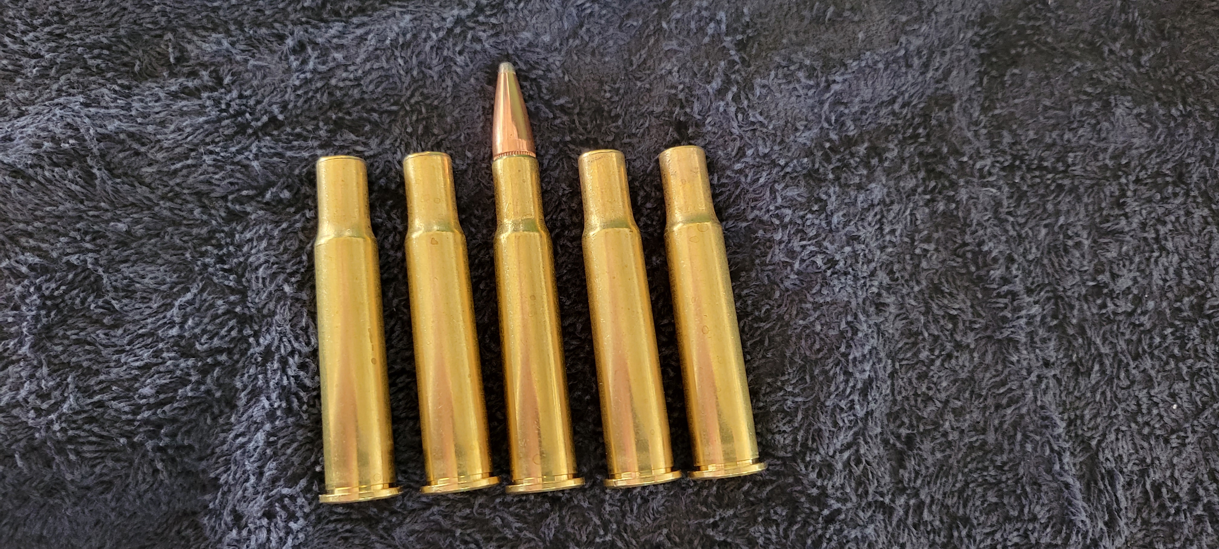

    So I loaded up a bunch of rounds and brought the Kragicon to the range after an extensive breakdown and cleaning. These rifles have an excellent reputation for accuracy and this one didn't disappoint.
    The load formula is new Hornady brass, Federal 210 primers, 41.3gr IMR 4350 topped with a Hornady 180gr Spitzer. I didn't chrono it this time but according to the book it should be right around 2100fps which is the standard Army ball velocity. Obviously the rifle likes this formula a lot and ill be refilling the spent cases with the same thing. Brass came out of the chamber looking pretty much as it went in with no signs of stress whatsoever.
