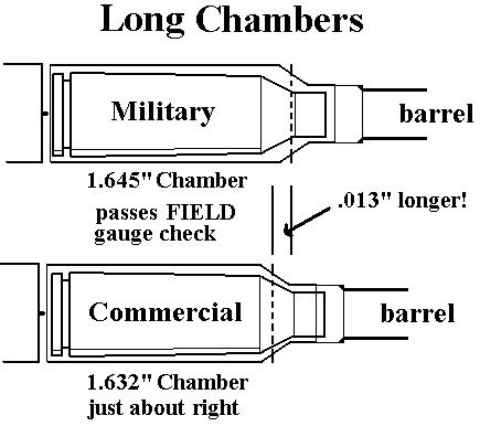

    The 308 and 7.62 have different headspacing, and the 7.62 case is much thicker and heavier than the 308 case, using 308 cases in a 7.62 chamber can result in case failures.

Name:	308 Vs 7.62.jpg‎
