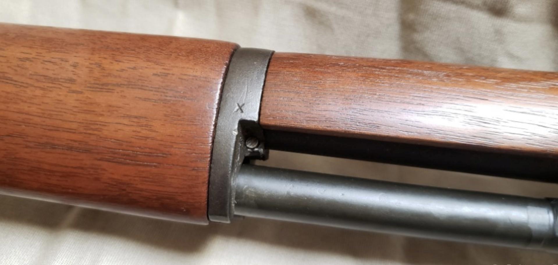

    One thing that stands out to me is an “X” marking on the left side of the lower band. A photograph of the marking can be found here: https://imgur.com/a/nq16tZt
    Does anyone know what this means? Is it the letter X or is it a cross?
    Thank you!
    - Michael

    Here's the picture so others can see it readily...

    lower band single letter stamp
    There is a collector, Ed Byrns, who is often on the CMPicon website who keeps track of these lower band letter stamps. he has maybe a half dozen or so to date. Found on both arched and flat bands starting in 1942 and a few in early '43. All Springfield and reason for the letter stamp is not known.
    I have one on a mid 1942 SA rifle and have seen others too.

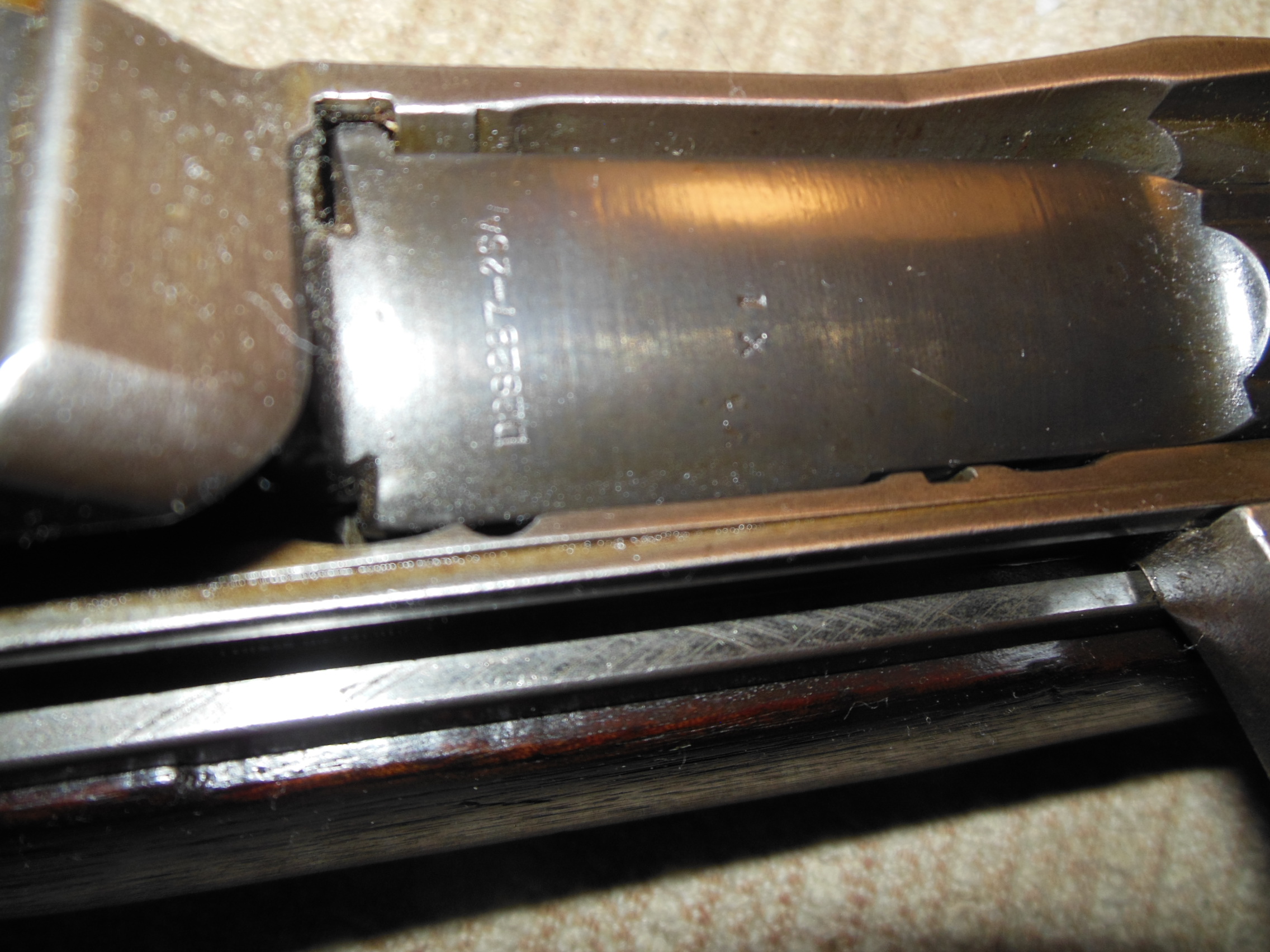

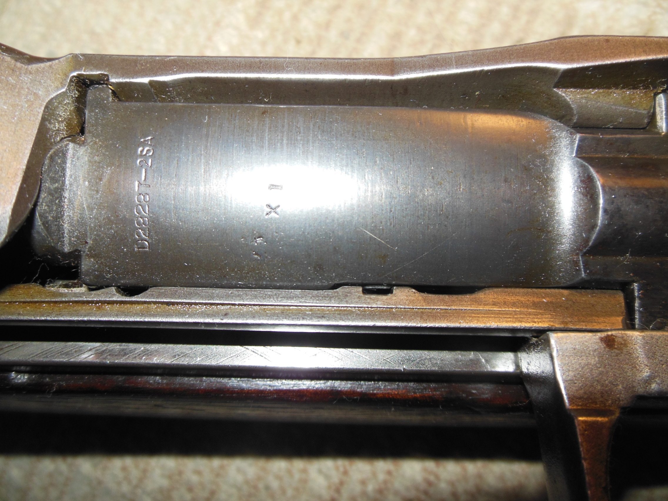

    Revision 2 bolt marked X 1
    Thanks Ed for posting the list of lettered lower bands. While on the subject of X marked parts, years ago had a friend in Calif that found a revision 2 bolt heat lot X 1 in a SA 63K rifle with a S-A 8-40 barrel. The rifle was damaged and the parts were being sold, I was able to buy the bolt. So far I only know about two other bolts also marked X 1 but not in rifles. The data charts posted never show the X 1 bolt so has to be uncommon to find.
    Photos show the X 1 bolt
