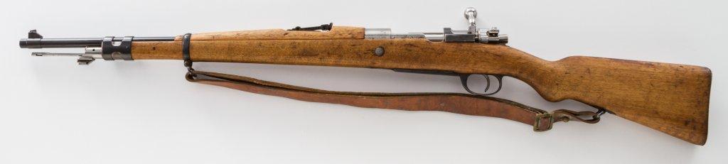

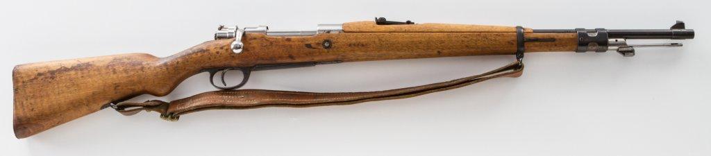

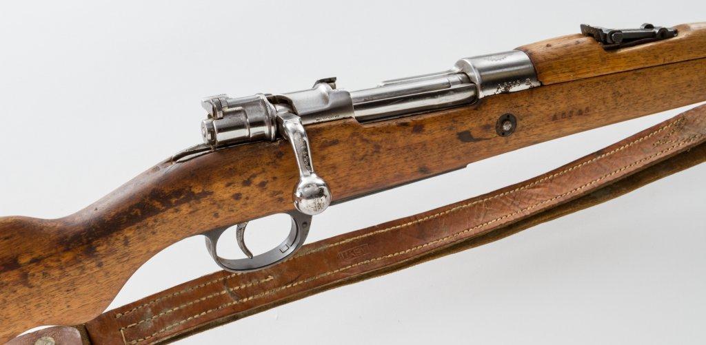

    I know this is an old thread, but I just saw it. This is the sling that came with my Engineers carbine. I do not know if it is correct or original.
