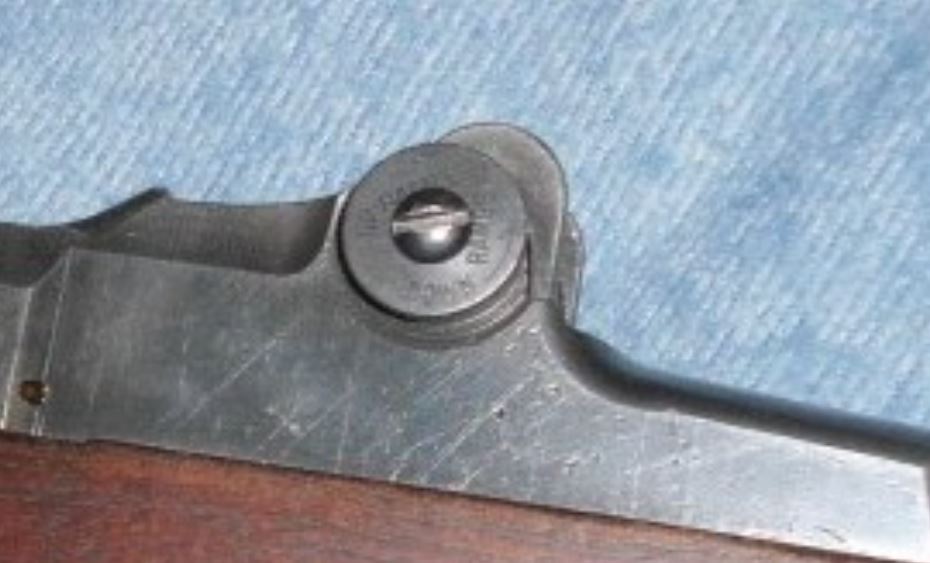

    Hey all,
    I don't mean to bloat the forum, but I'm not sure where else to ask technical questions. I'm still learning about M1icon rifles so I am bringing all my questions here to bother the experts.
    I'm looking at a particular rifle that has an amalgam of parts assembled into the rear sight: a Springfield Windage knob, a Winchester Lockbar, and a Winchester Elevation Knob. The screw holding the Elevation knob is what is standing out as I have never seen that before. It doesn't look like a screw on the T105 sights, just a regular old screw. Has anyone seen that before?
    Finally figured out how properly upload photographs. Thank you Bob for the walkthrough!
    Respectfully,
    - Michael

    You're quite right, just a round head slot...have you taken it out to see what thread is present? Here it is in blowup...

    The rifle is admittedly not mine, I saw it as a listing online. It is a 6 digit Winchester with Winchester parts (although not contemporary to the receiver).
    It is a peculiar piece that stuck out to me. I doubt any armorer would jerry-rig a design like that at an arsenal.

    Quote Originally Posted by Ms15710 View Post
    No, correct screws are even available to the layman...

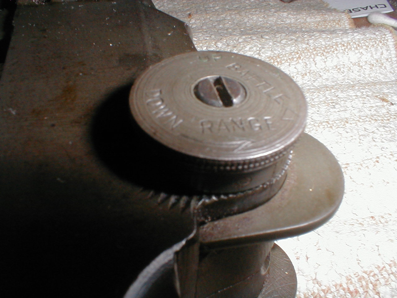

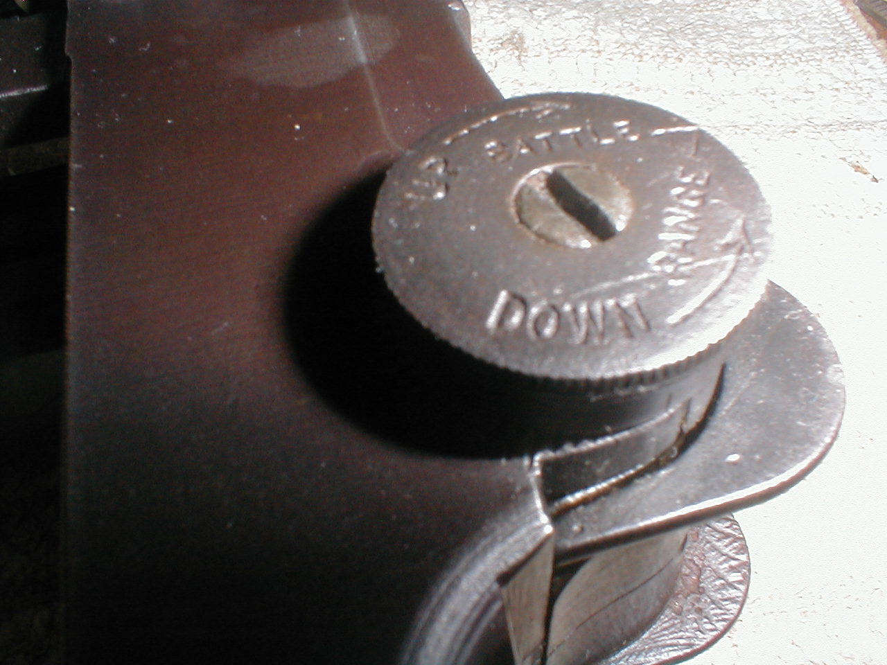

    elevation knob screw
    It is not just a small machine screw but manufactured to fit the pinion and hold the elevation knob tight
    Well, the outside screw is a screw...and it's wrong. The outside is holding things tight I guess.

    The trouble is if someone has forced in a screw with the wrong thread they may have messed up the thread in the part that the screw fits into, the pinion.
    Yes...
