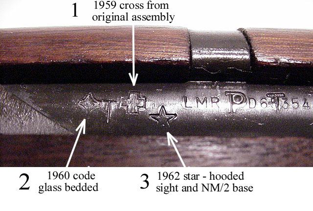

    From post by Bob Seijasicon
    Annual Marks - http://www.milsurps.com/showthread.php?t=35777
    1959 = Greek Cross, looks like the block Red Cross symbol
    1960 = 4-point star, looks like the stars in the Pittsburgh Steelers logo
    1961 = Triangle
    1962 = 5-point star, usually part of NM star PT in a row
    1963 = 7791036 NM barrel without annual code in the chamber area
