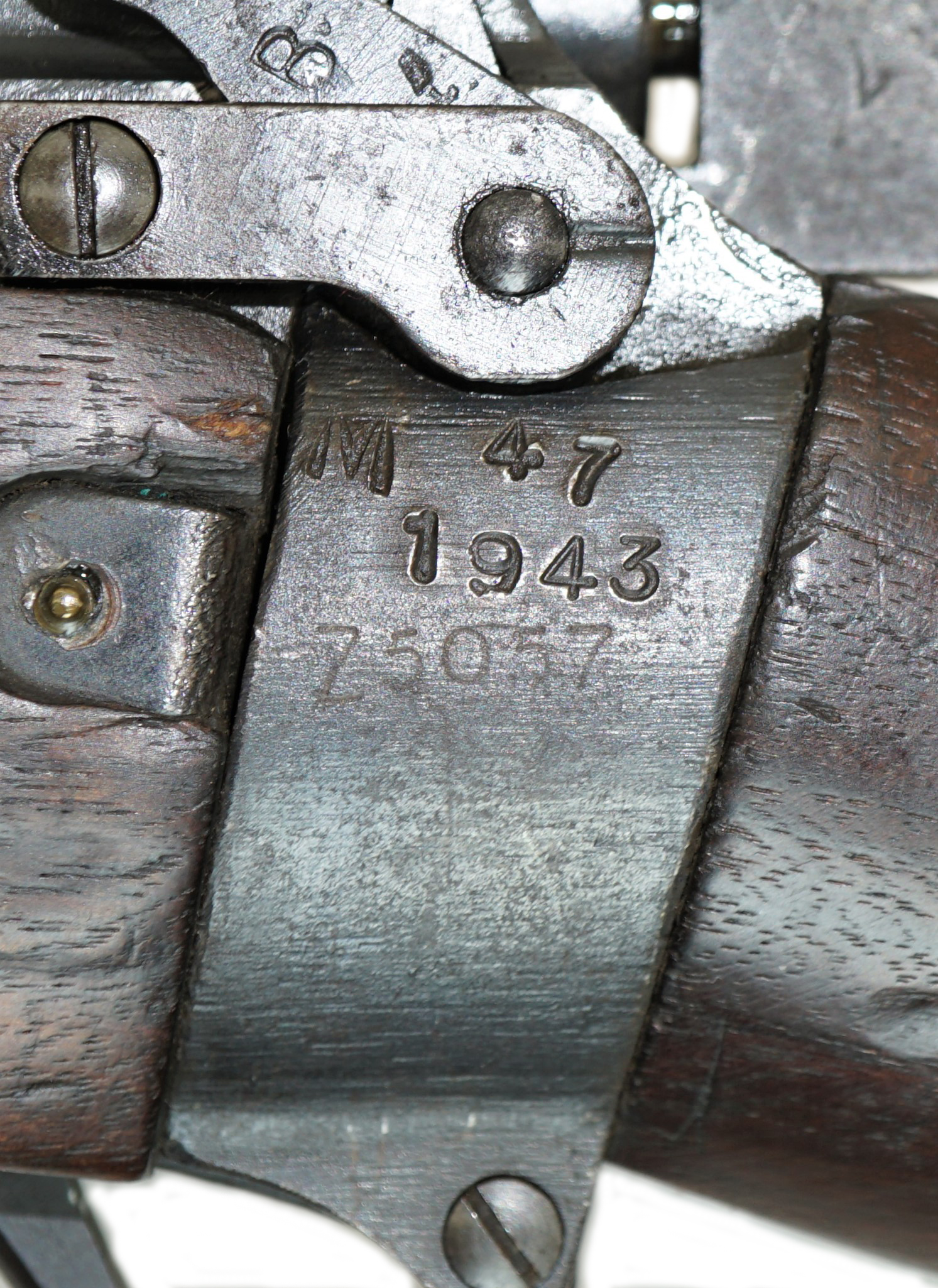

    Just doing research for the next book and saw your posting.
    To answer an old question, yes BSA went through the alphabet and made it to Z. I just picked this girl up. I have also found pictures of one in the Z9XXX range.
    I am currently trying to find the approximate end of the "B" and the start of "M47". The picture of the X rifle has been lost, do you remember which way it was marked?
