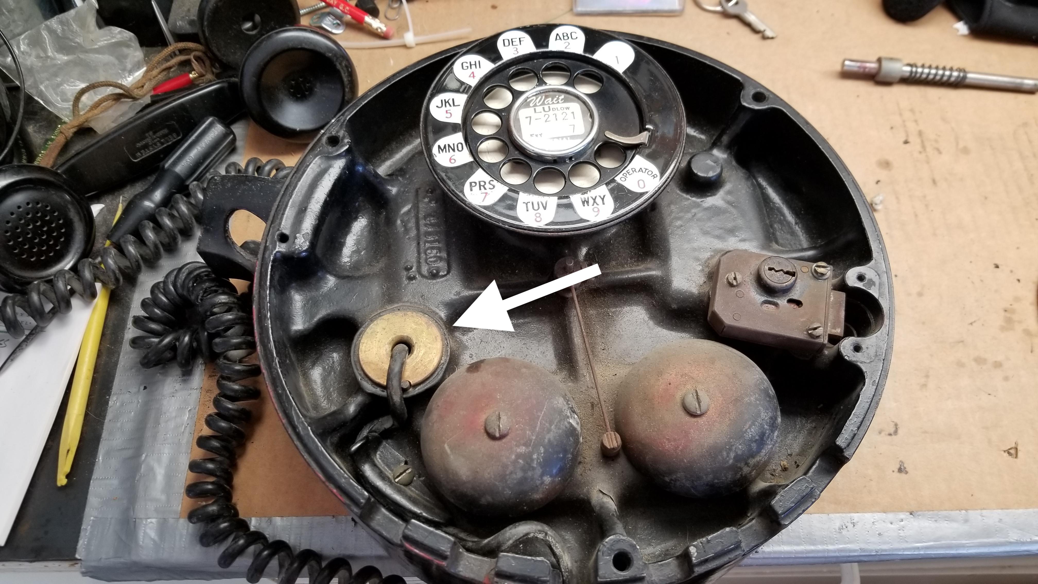

    It's missing the key and the inside cable gland on the handset. Well, wouldn't ya know my luck always comes through, eventually...and I found not only a key, but a later 520 series in near mint condition...complete with its cable gland to replicate for the 320. I'm hoping to find a milsurp friend with a lathe willing to help me make this rather simple set of brass parts.
    Here is a stock image (since I already disassembled mine) behind the front cover. Arrow pointing to the part I'm talking about...
    Now On the backside of the bulkhead...

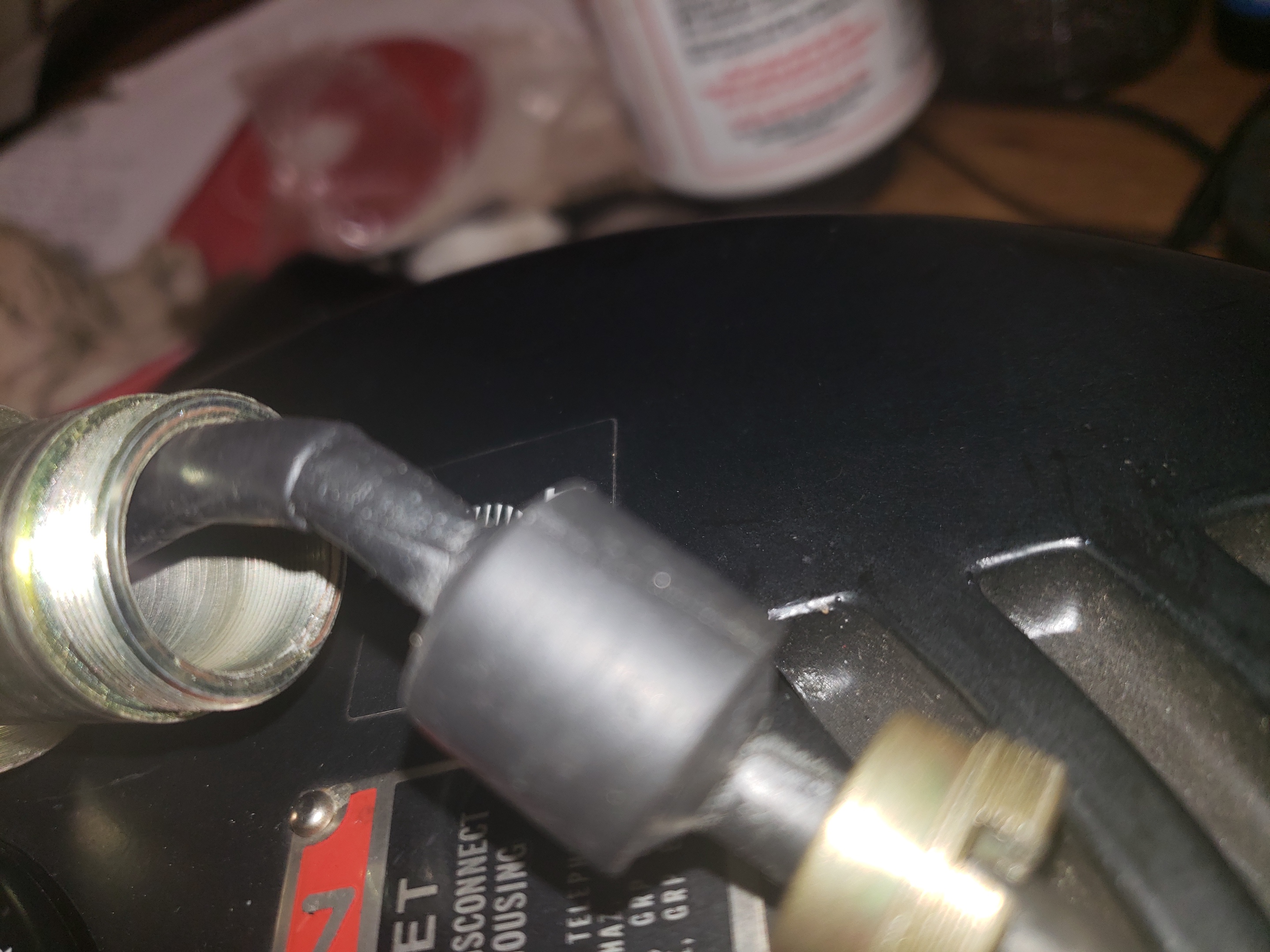

    I cannot remove the handset without splicing the handset cord. The speaker/mic covers are welded/sealed on, and the heavy rubber knob that forms the seal was spliced in and heat-welded to the rest of the outer insulation. Nonetheless, I can dissemble enough to get accurate measurements.

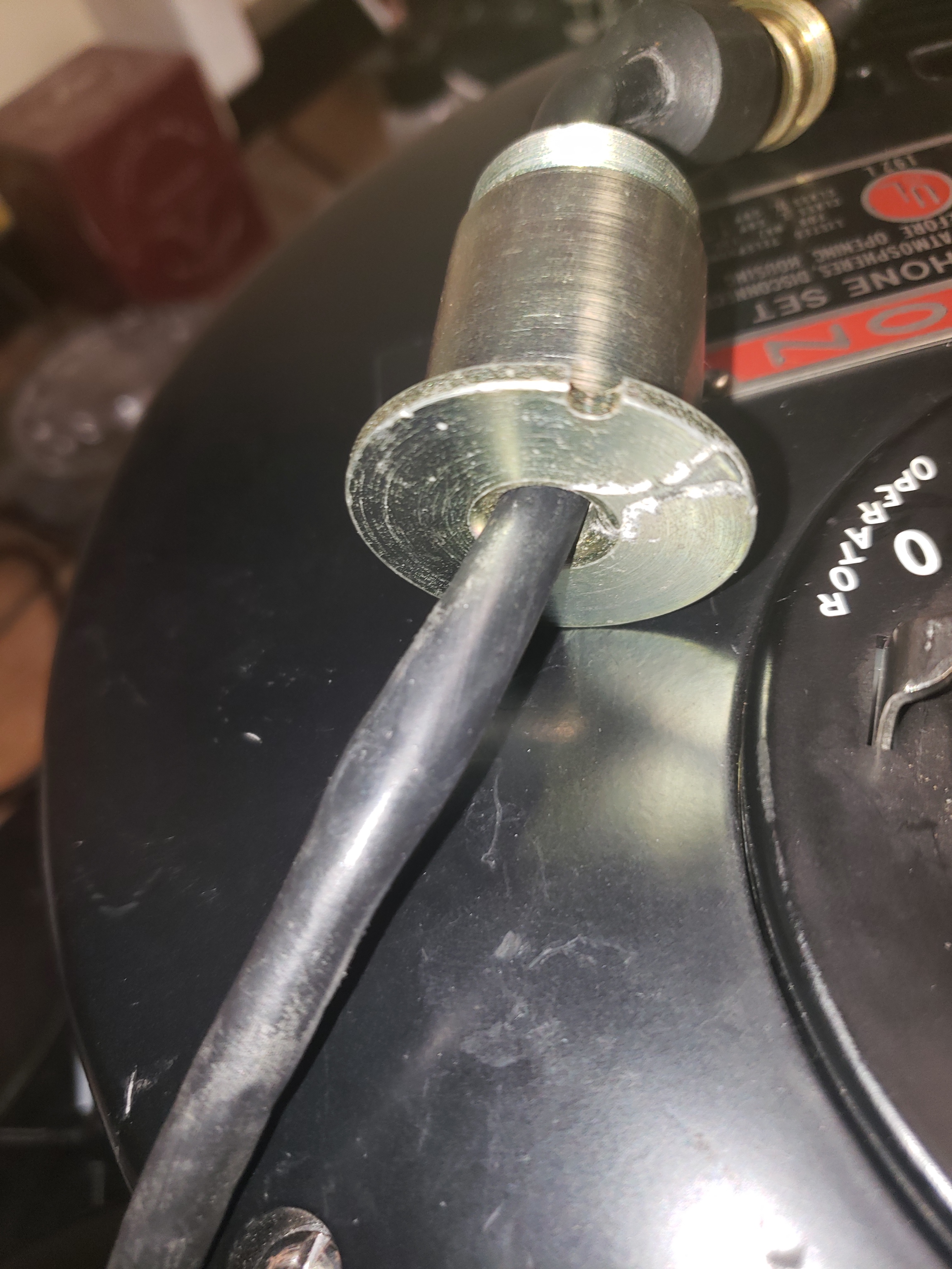

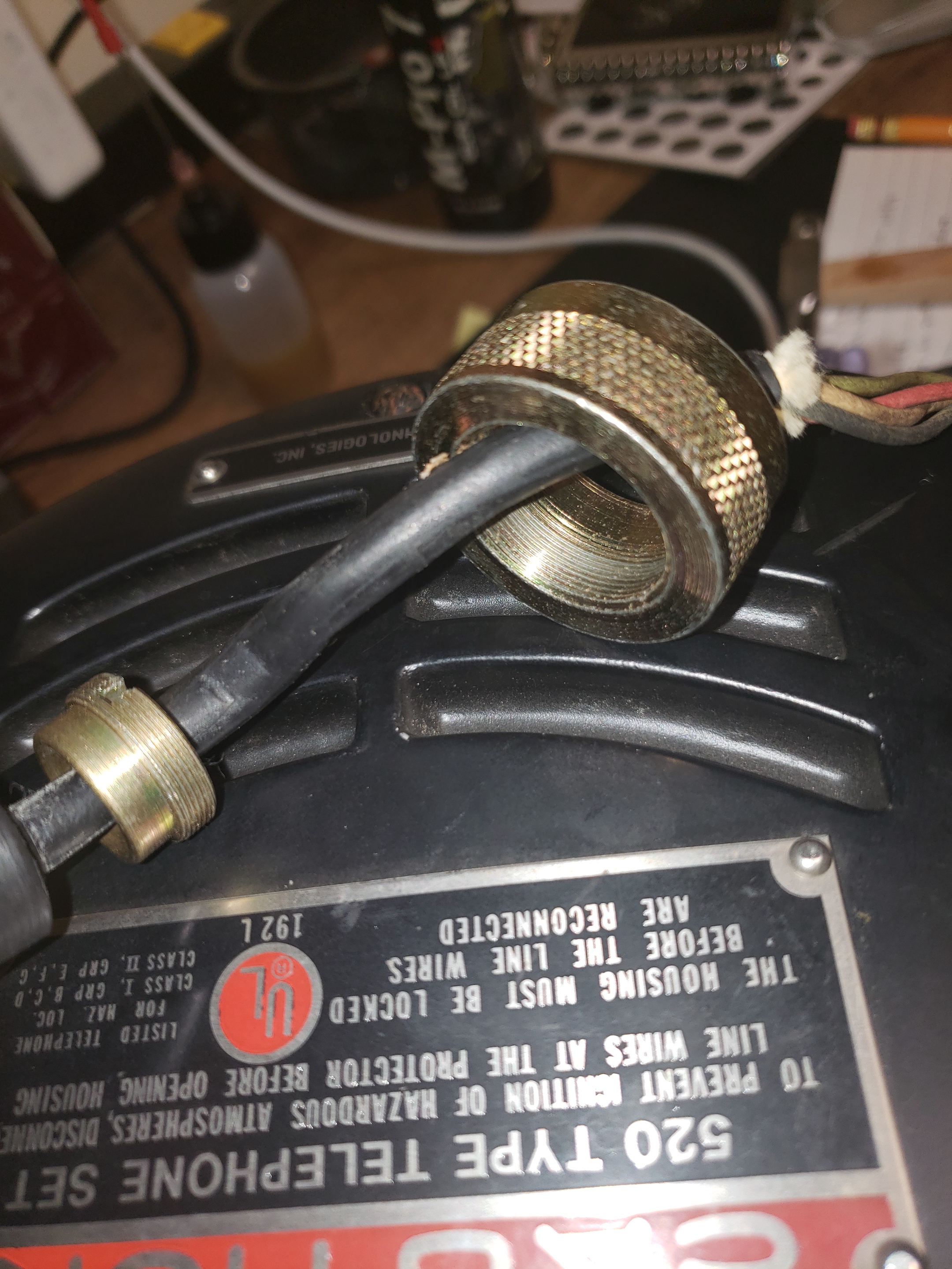

    It's in 4 parts. 1) outer sleeve that passes through the front of the bulkhead. 2) a nut that screws on to the outer sleeve from the inside...in the event of that internal atmosphere sparking, the explosion would expand the outer brass sleeve to seal against the bulkhead. It's a tight fit to the bulkhead, but not a press fit. the brass sleeve plus out with fingers, but is a perfect fit. 3) the solid rubber knob on the cord's insulation is compressed by 4) the inner compression nut.

    If you look at your first pic on the bottom row of pics, post 1, you can see that, on the outer sleeve, at the end of the threaded portion, there is an "undercut" suggesting that the thread was turned on using the lathe's "lead screw", as would be expected. This is for the "run-out" of the cutting tool so that when the cut is finished the tool is not actually cutting any metal. If this "undercut" was not there normally the very tip of thread cutting tool gets broken off.
