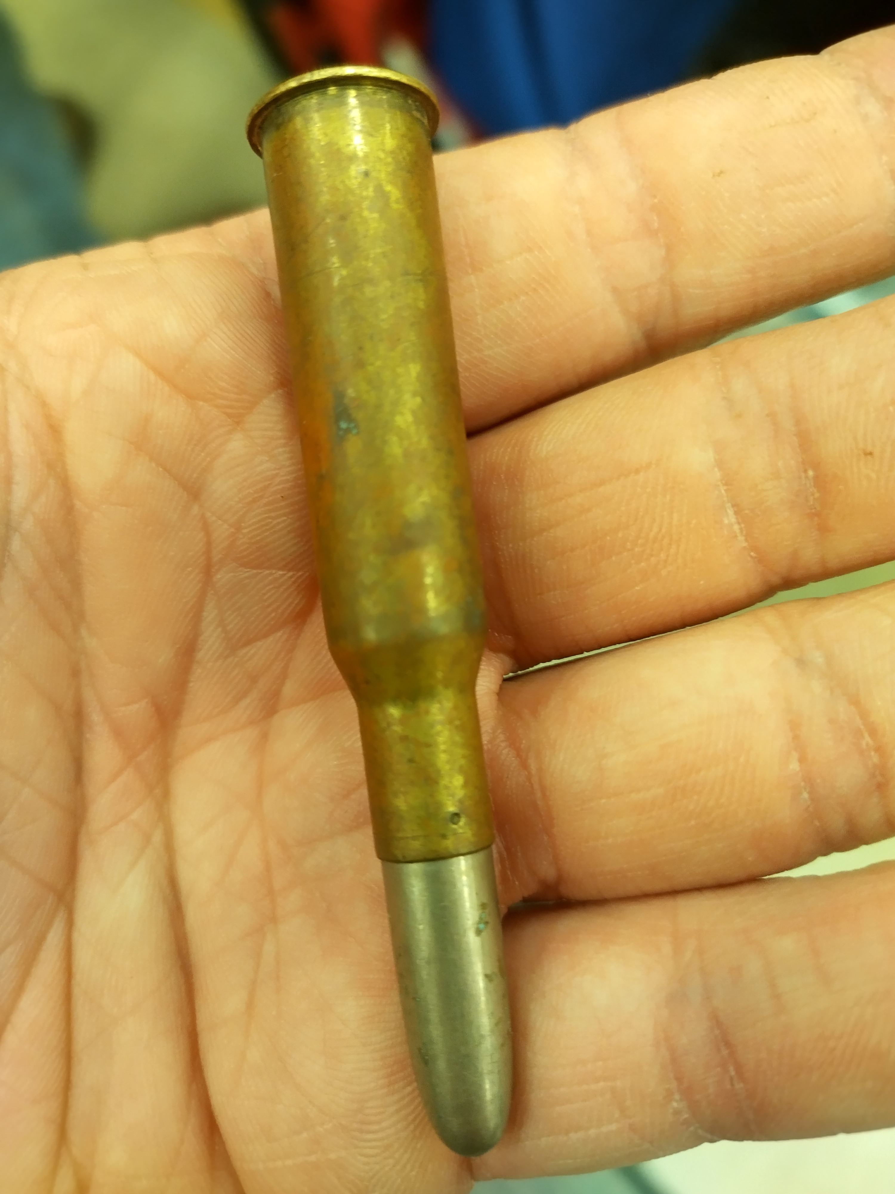

    Went to a local show today and had some fun digging through the bins of loose cartridges. Pulled out this cartridge and gave up $1 for it.
    Originally thought it was a rare Jager 7.62x54r, possibility WW1 US Reserve issue. Lined up to an identified cartridge, it matches to 54r in most dimensions except shoulder angle. Any hints to what this may be?
    https://ibb.co/x2mvJqN
    https://ibb.co/58pbFjV

    Yes, it looks like a 7.62 x 54 rimmed.

    A US made 7.62x54r cartridge made for the US made M-91 rifles that stayed in the US . Being a rimmed round the shoulder angle does not mean anything . The 30/40 Kragicon was never known by metric in the US .

    early Russian 7,62x54r
    The Russians used the early round nose FMJ 210 gr bullet until replaced in 1908 by the 148 gr spitzer bullet (which took years to replace)
    The US Cartridge headstamp on your cartridge has the early Russianicon round nose bullet
    I have a 45-70 case with the US Cartridge headstamp too
    Photo shows early Russian pre 1908 cartridges in a clip

    I have a .30 cal cartridge I picked up in Ft Lewis at an old MG position that's marked to the US Cartridge Co as well, yes they made lots. I wonder if since they were such an early company (1918) they were making this ammo for the Russians on contract?
