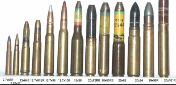

    The picture here shows the representation of the cartridge you speak...mentioned specifically as 7.7x56R and see the Italianicon designation. Also the Japaneseicon had a designation and cartridge. Here's a pic to accompany. So yes it's a .303.
    WW2 AIRCRAFT GUN AMMUNITION (1) 7.7x56R (.303 Britishicon, Italian/IJN 7.7mm), 7.92x57 (MG 15, 17, 81), 13x64B (MG 131), 12.7x81SR (Breda-SAFAT, Scotti, IJA Ho-103), 12.7x99 (.50 Browning M2), 12.7x108 (Sovieticon UB), 15x96 (MG 151), 20x72RB (Oerlikon FF/IJN Type 99-1), 20x80RB (MG-FF/M), 20x82 (MG 151/20), 20x94 (IJA Ho-5), 20x99R (ShVAK), 20x101RB (Oerlikon FFL/IJN Type 99-2)

    7.7x56R and 303 are the same ctg.
    During WWI Italyicon adopted the .303" cal Vickers and Lewis guns for air service making the 303 Britishicon ctg their standard air service round. They also developed their own designs of aircraft MGs in 7.7 and projectiles.
    Same story with the Japaneseicon 7.7 RIMMED ctg.
