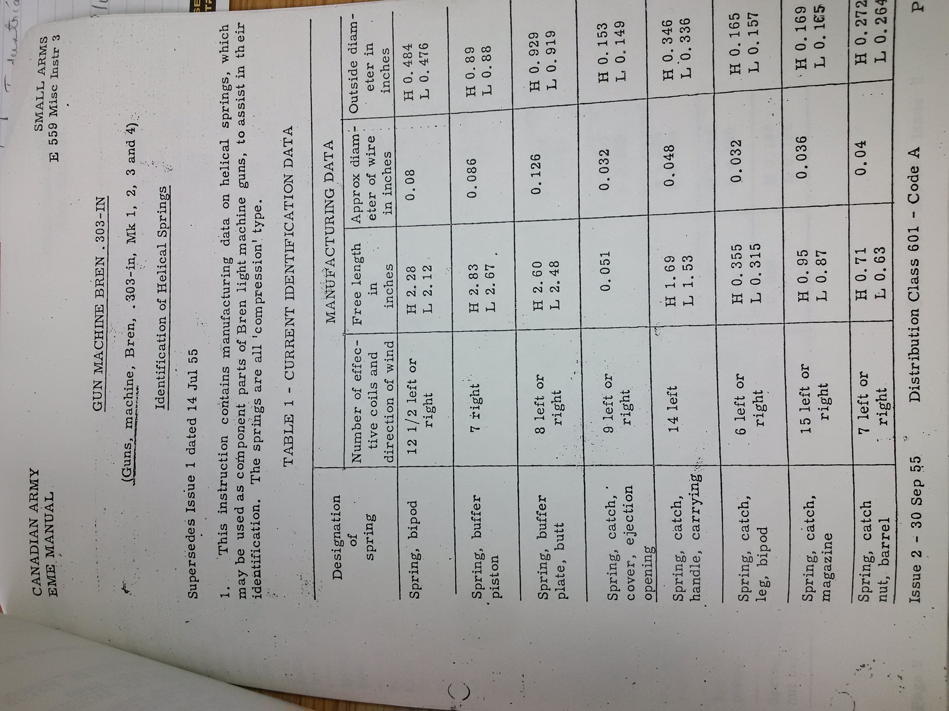

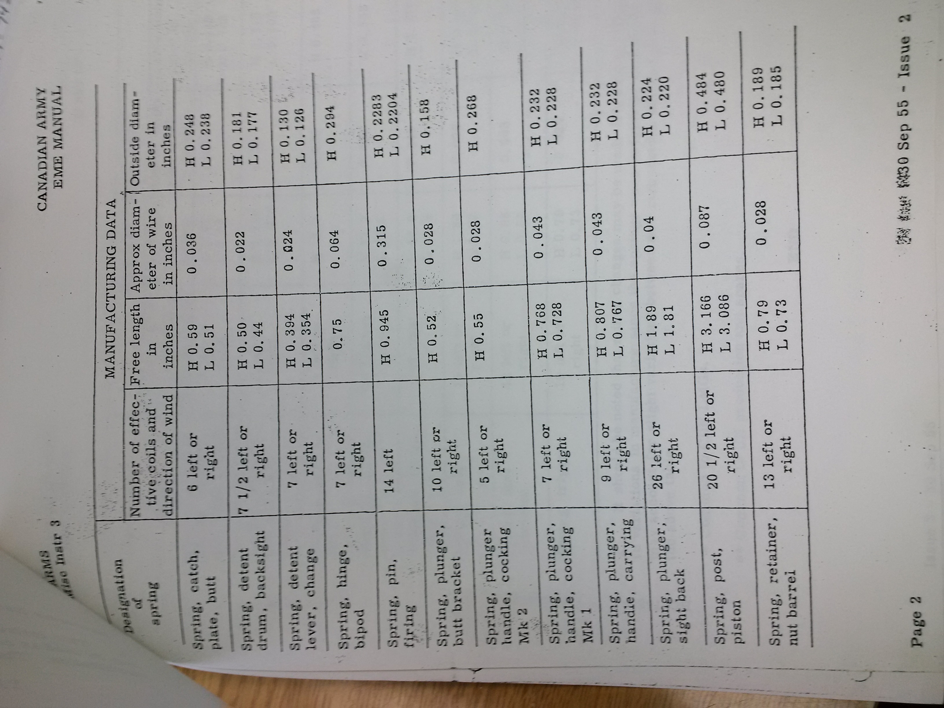

    Here is the 1955 Canadianicon EME springs use in the Bren.
    I suspect that the MkI spring had more than 6 coils (probably a typo?).
