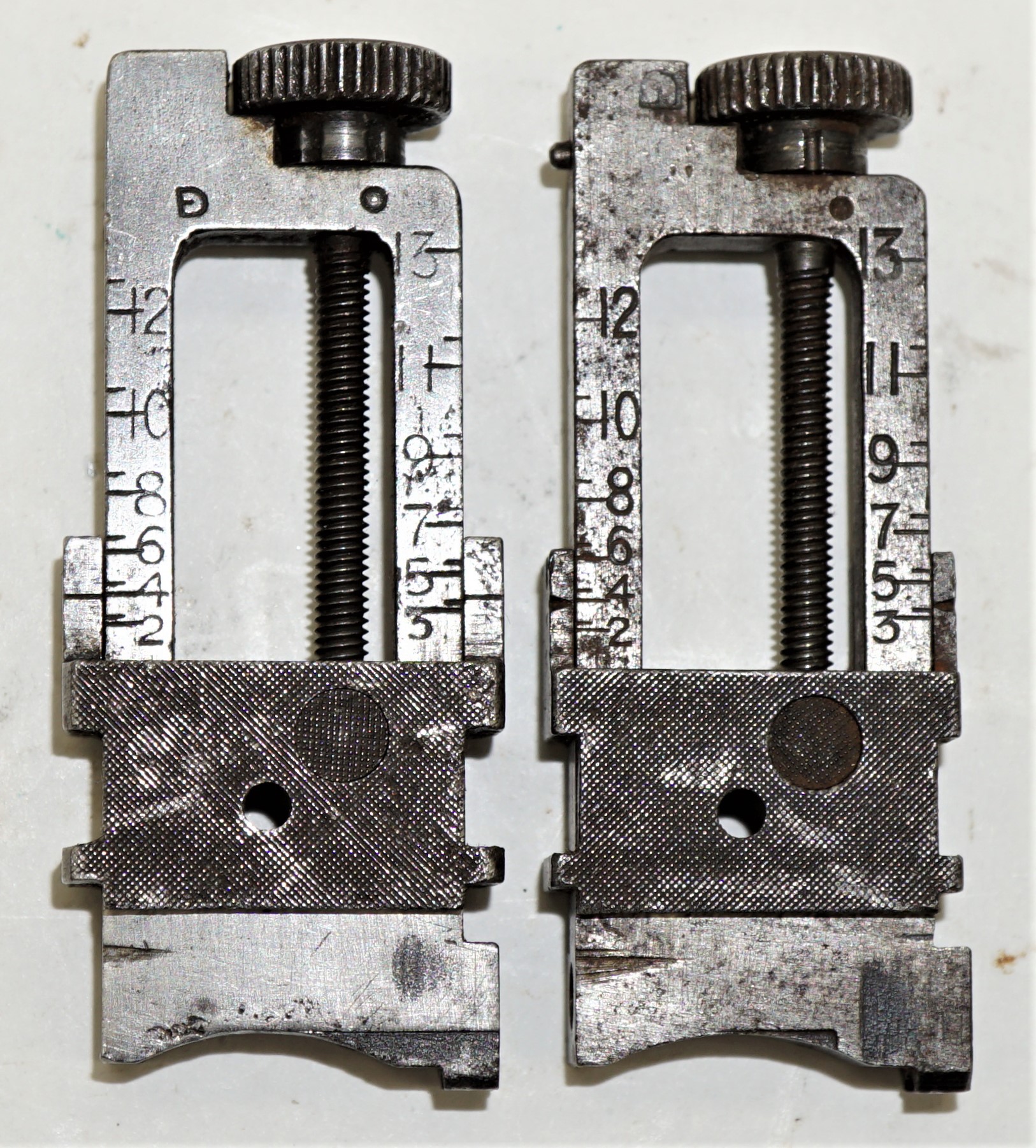

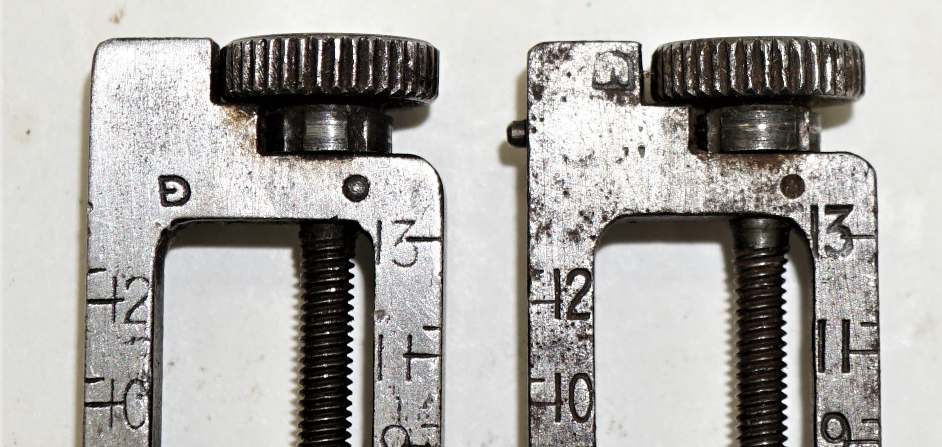

    If you search long enough a piece of gold can be found. This time a Trials No. 4 rear sight modified for sniper service. Slightly different markings than my other spare (right) this one has the elusive 6-click adjustment wheel that Roger promised me existed that I have only seen in pictures.
    Well Roger, finally found one!

    I bet you thought I was fibbing!
    Nice find!
    My 31 Trials is four click & my 33 is a six click. The sight on the 33 is the only one I've ever owned.

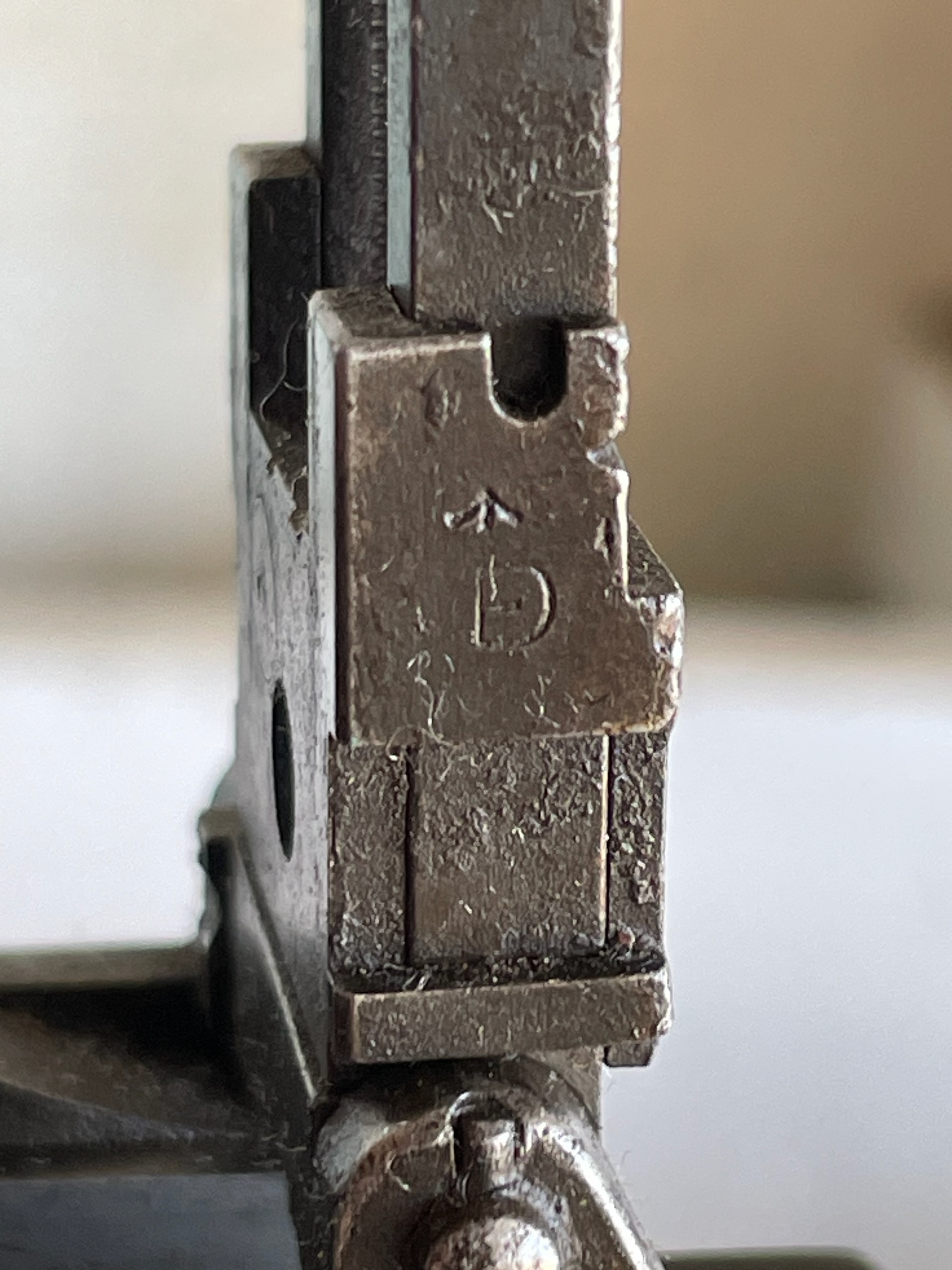

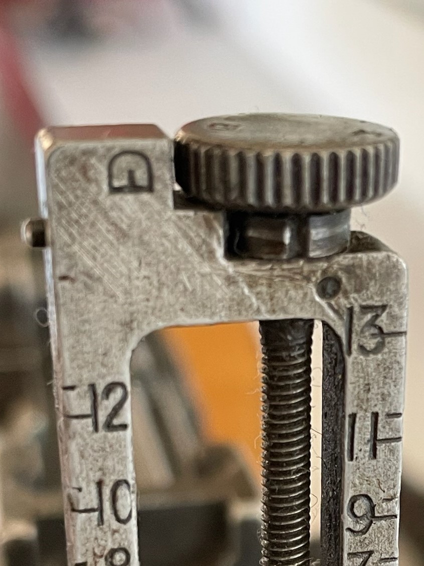

    BVZ24:
    The trials sight has the distinctive superimposed E within F within D mark. The standard No4 sights are marked with F for Fazakerley, B for BSA, SM41 for Singer, and the squared S for Savage. Also, the underside of the base is different in that it has the rounded notches to engage a little spring loaded ball bearing. The later, production model sights have a flattened step that engages the top of a plunger.
    Pics attached.
