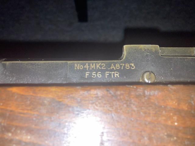

    I have been trying recently to educate myself about the Irish Contract Enfield Riflesicon. I have a Fazakerly built 1956 No4 Mk 2 that is marked “F 56 FTR” as opposed to “UF 56”. I can’t see any markings on it to give evidence of a previous life before the FTR. I have read that these were possibly put together from new parts but marked “FTR” for some reason.
    Can anyone enlighten me on the history and story behind these rifles?

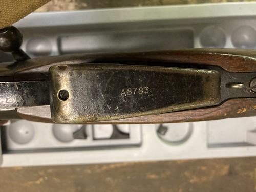

    It appears to be all matching. Bolt, receiver and magazine all have the serial number engraved on them. All components appear original though I haven’t taken the time yet to cross check every stamp. I see no evidence of any markings being removed or re-stamped. It appears to be a “new” first run rifle, not a “FTR”. I am by no means an expert but every FTR rifle I’ve seen has some evidence of its previous life.

    Quote Originally Posted by Thunderstreak View Post
    https://www.milsurps.com/images/impo...007994_z-1.jpg
    The fact the rifle is marked as having an FTR at the Fazakerley factory in 1956 tends to suggest that it has been FTR'd.
    An FTR would replace worn parts such that rifle was at least 80% as good as new (80% life remaining)
    The serial number is A8783, a range which predates the UF series by some years
    Legacy Member GeeRam's Avatar
    Apr 2017
    06-02-2025 @ 03:54 PM
    Berkshire, UK
    884
    06-06-2025
    05:46 PM
    Its an oddity.
    '56 was when they changed over to the new numbering, and the UF A**** numbering, so the A**** number could be right and because its a low number and a new system, the lazy scouser forgot the UF prefix......
    But, that wouldn't account for the FTR stamping.....apart from its Faz
    Just the thing for putting round holes in square heads.

    Quote Originally Posted by GeeRam View Post
    Its an oddity.
    You'd have thought that, even Fazakerley, after almost 9,000 rifles, would be able to get the serial number prefix correct !

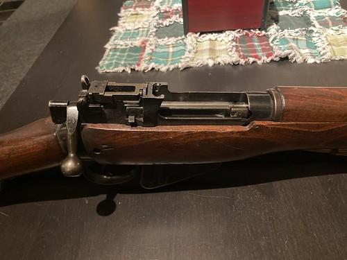

    Does it have the cut-off block on the right side of the receiver?
    If it does not, my theory is that Faz did not have contracts for new production, but did have contract for FTR.
    Is the left side the straight 45* angle shelf?

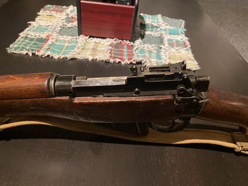

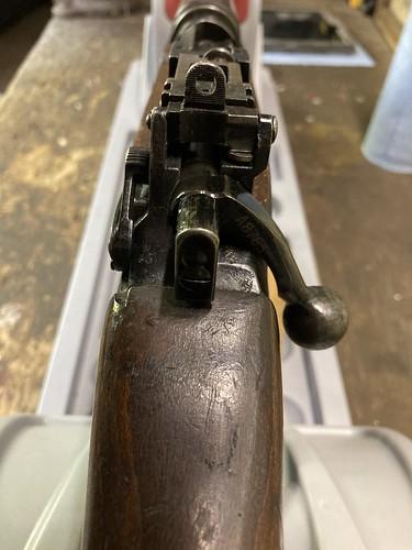

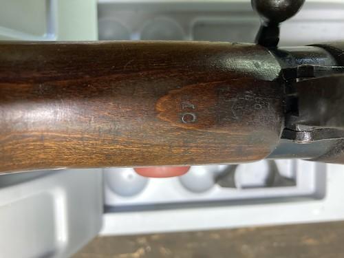

    Photos added
    A few more detailed pictures to help with the mystery!
