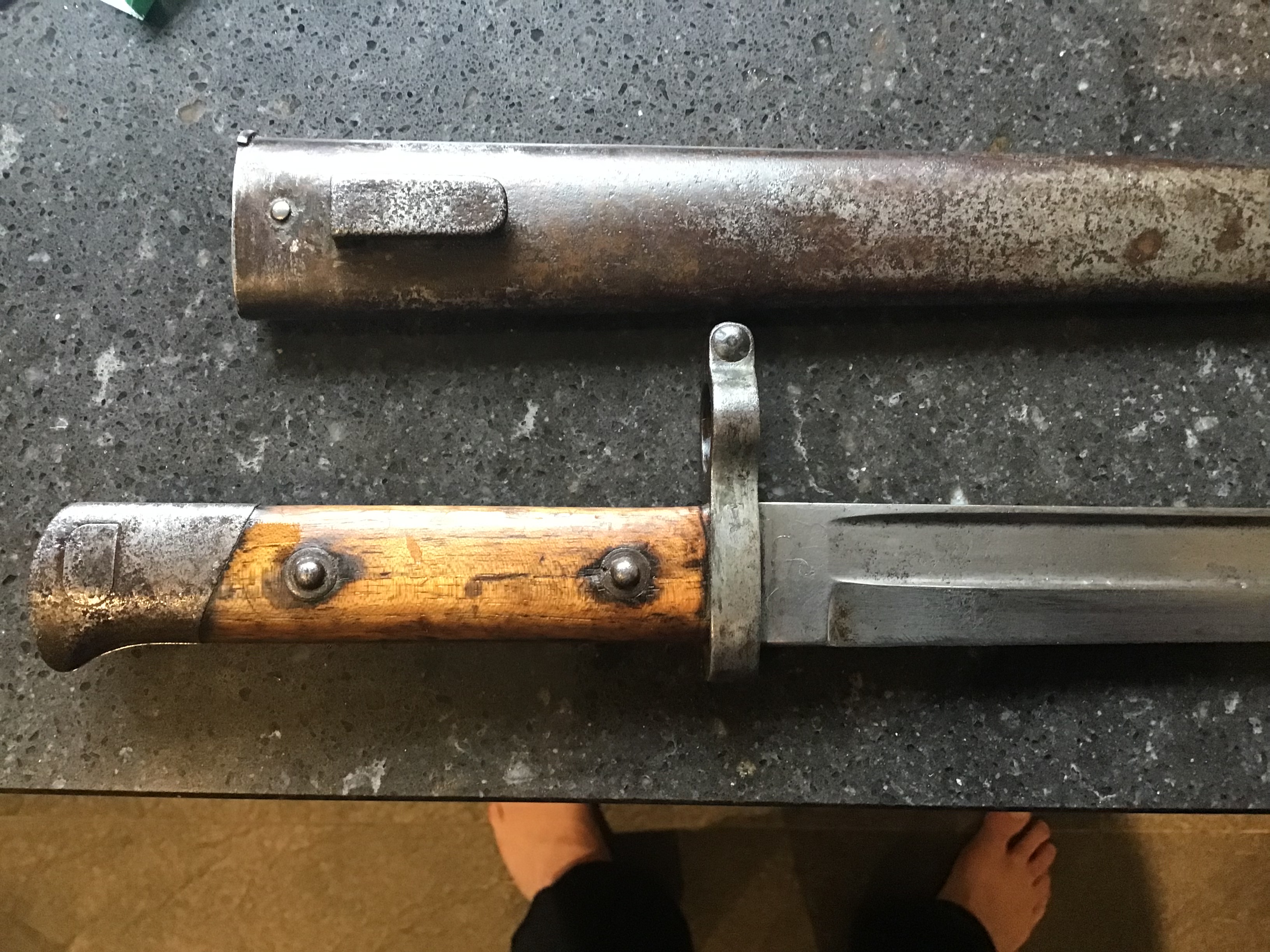

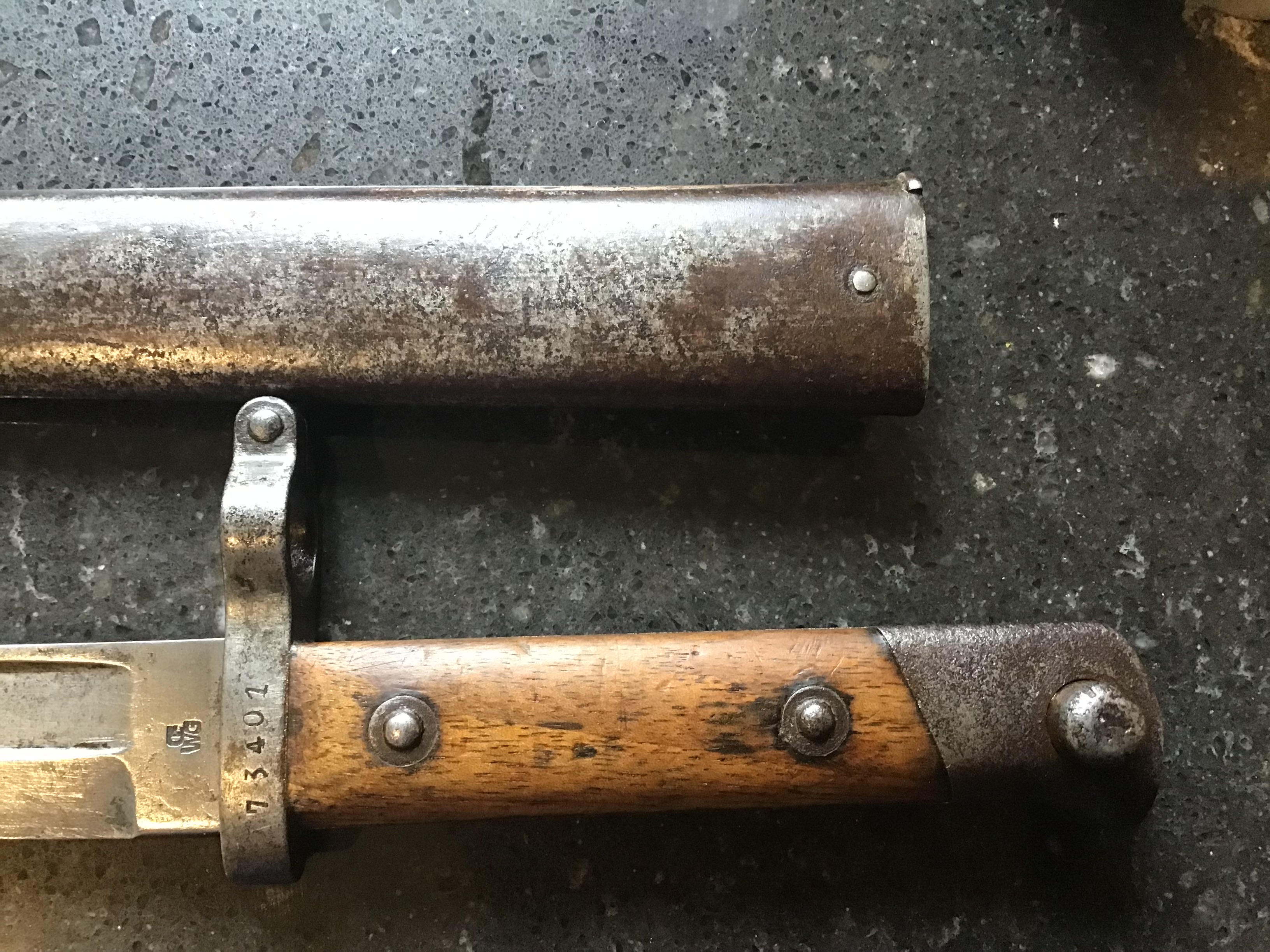

    In order to fit it to a rifle, I need to slacken off the muzzle ring screw on this Mannlicher M88 bayonet - which is currently well frozen.
    I was wondering if someone would kindly post a picture or two of what the screw looks like on these types of bayonets when it is undone so I can see what I’m up against?
    Thanks.

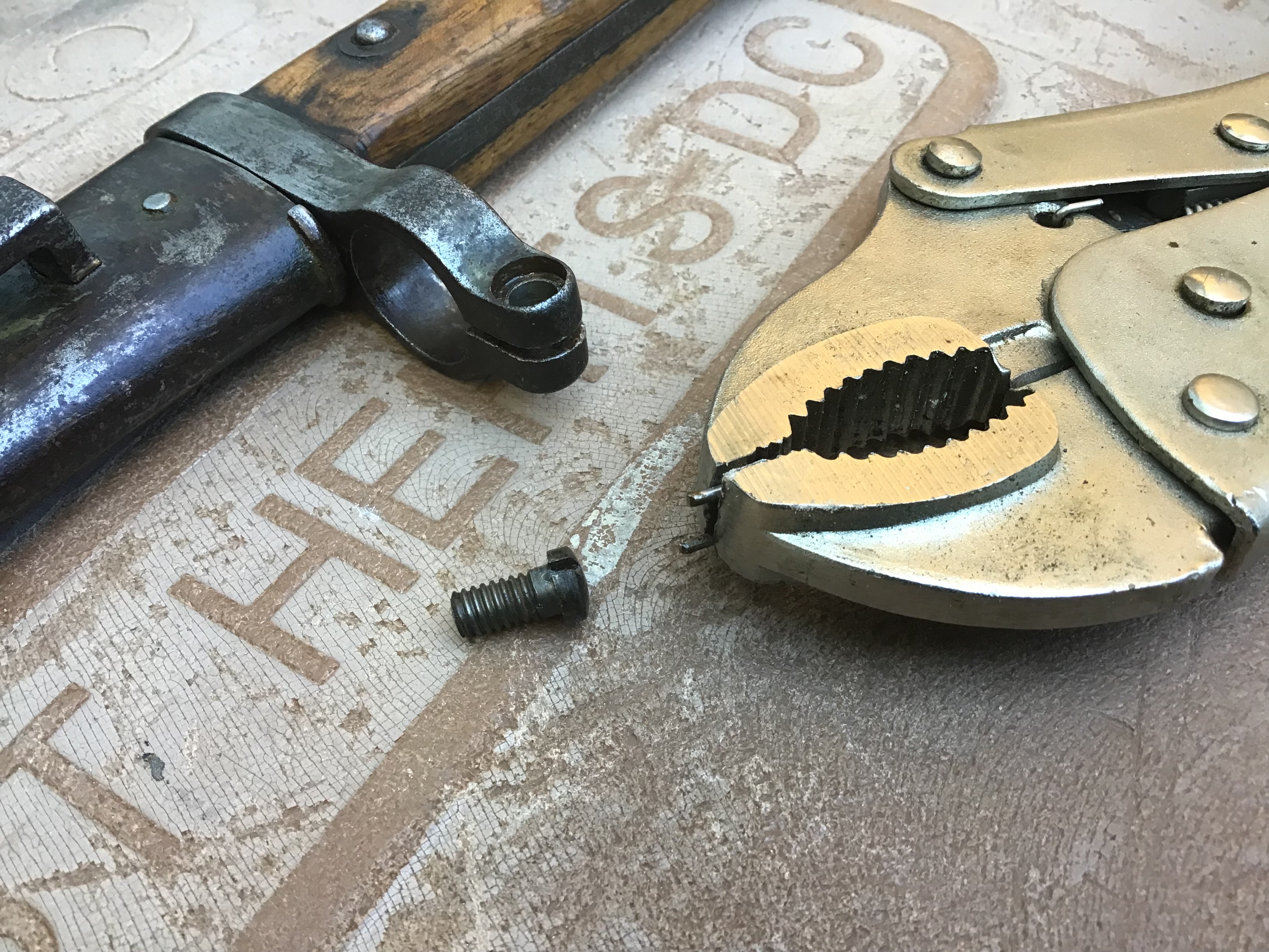

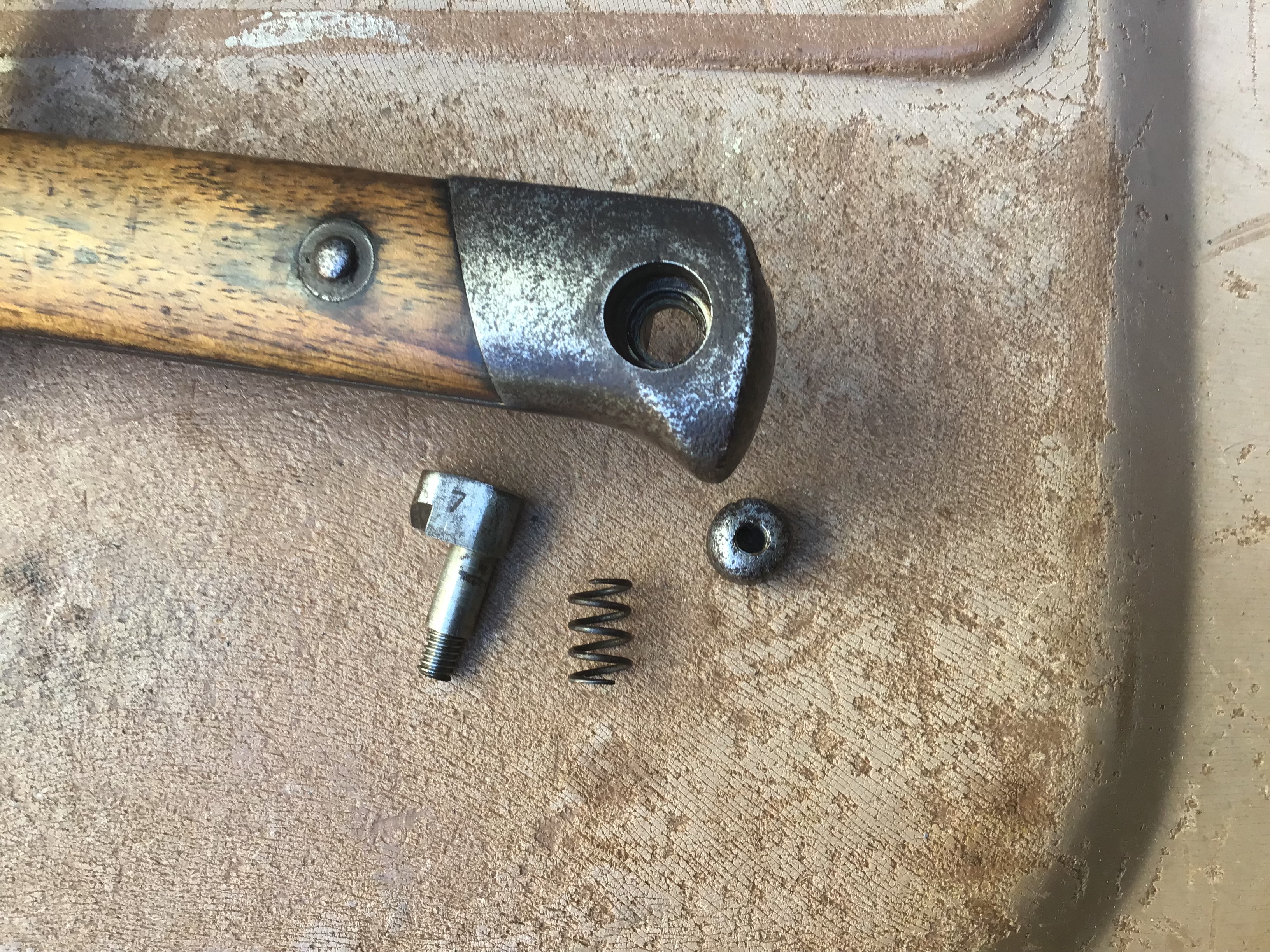

    Update. After cleaning as much crud as I could get at out of the muzzle ring, soaking it in penetrating oil for 3 weeks and improvising a dismantling tool, the screw undid with little difficulty. For a final giggle, I think I’ll try and dismantle and clean the locking mechanism.

    I succeeded.
