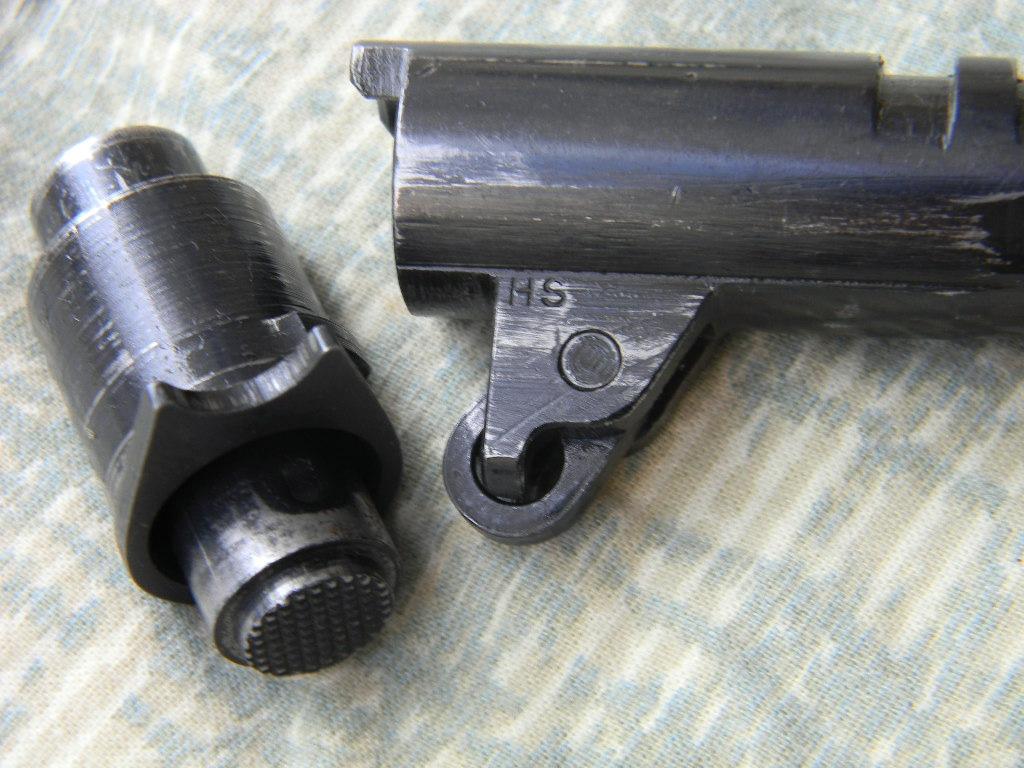

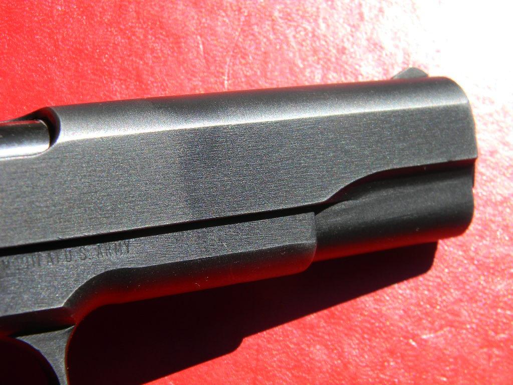

    First thing to do is to get good photos. The mosaic is about useless.
    Take nice, detailed photos like the following. In direct sunlight, DuLite blue will have refractive hints of red and green. The Ordnance wheel will cut through the finish.
    That being said, I think I can see that your gun is original finish. I think.
