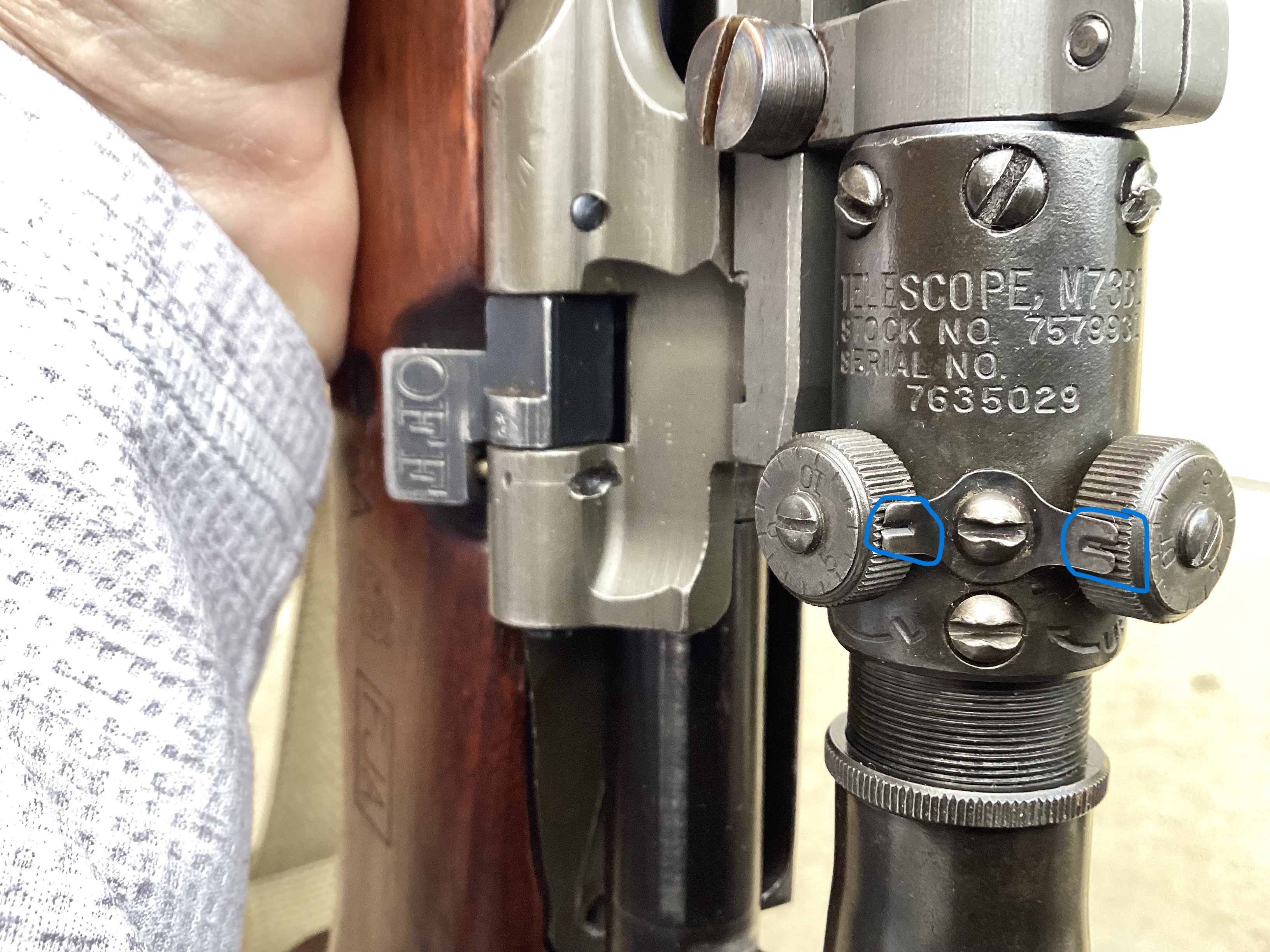

    Not really sure as I have zero knowledge or experiences with that scope
    But wouldn't the index mark be where I circled on the pic

    That's exactly where the index mark is - the thing with the 'later' M73B scopes though, is that the graduations on the windage and elevation screws are on inexable plates - loosen the central screw and you can rotate the plate to zero against the index mark.
    Best thing to do is to bore sight the rifle and zero to suit.
    The thing I've found with mine is once its zeroed its not very accuarate to return to zero (if that makes sense) - all down to the primitive spring arrangement inside the scope

    Thank you so much guys. That’s what I was thinking but wasn’t sure TM 9-270 says absolutely nothing about where the index makers are. Your right, those 2 groves ate the only thing that makes sense.
