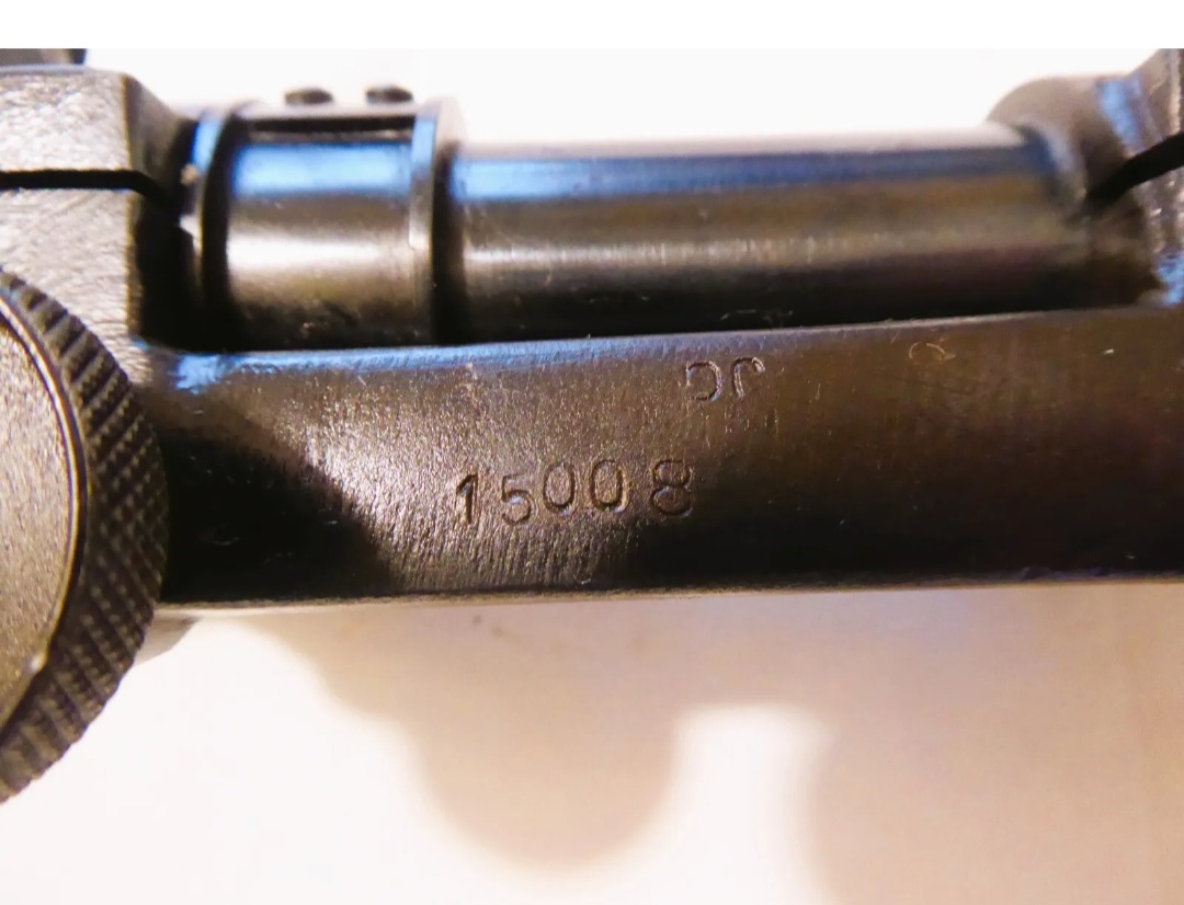

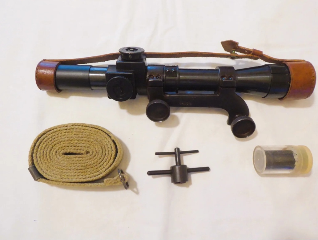

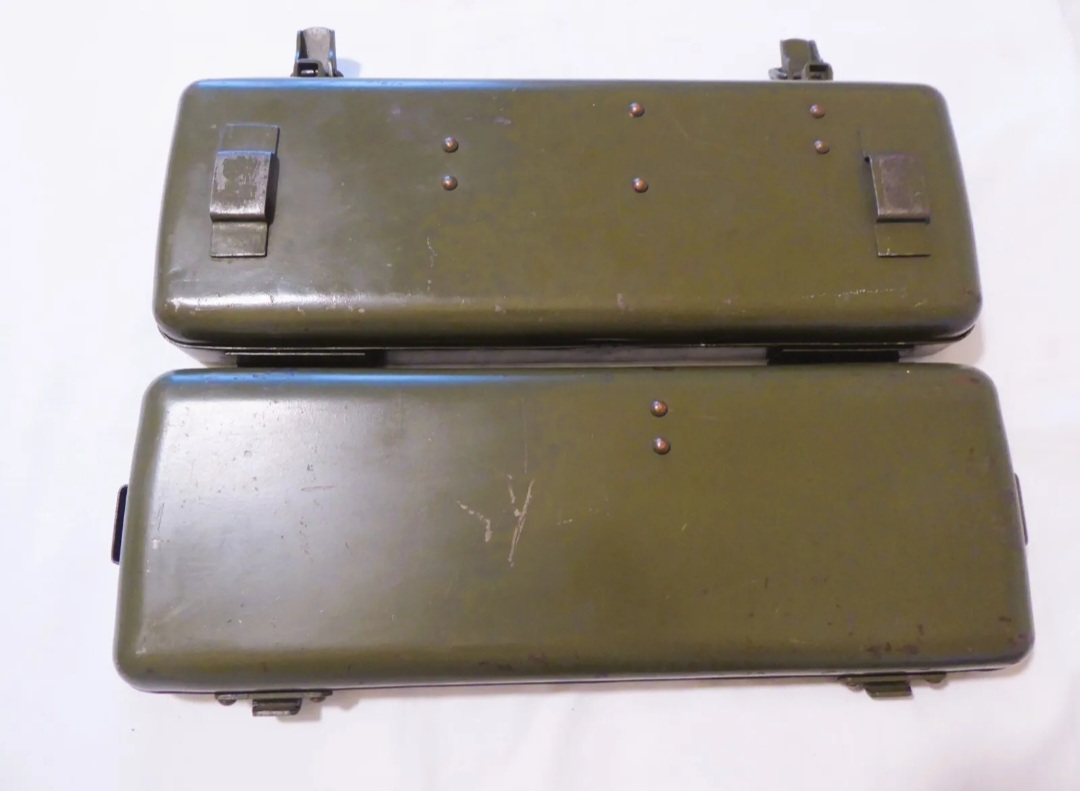

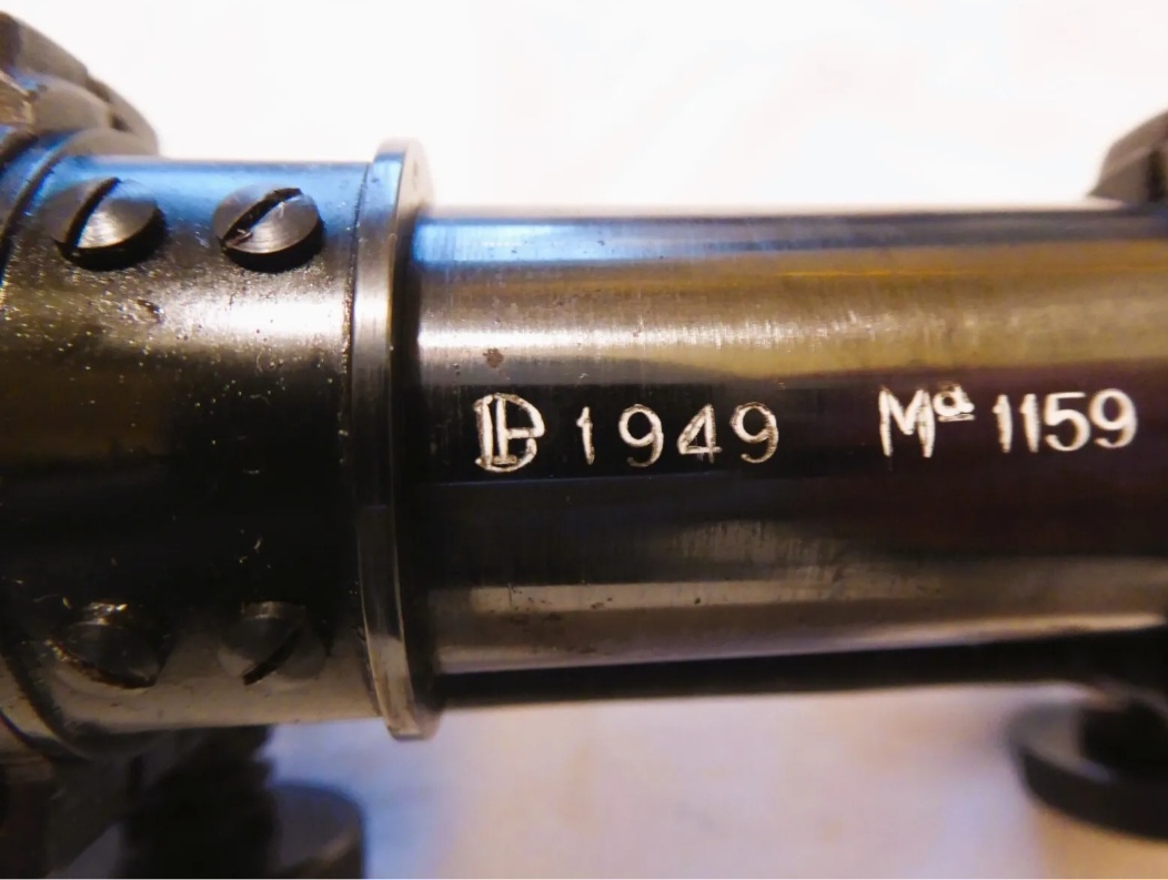

    Hopefully these pictures load

    It is not a mk3 judging from the offset turrets. It sure looks like a repro in the last picture.

    I noticed it's not a mk3 as well, I should have mentioned that while i was typing this up on my break.no markings on the scope tin. It just caught my attention because of the date of manufacturer. Curious to hear more opinions on it! My first thought was reproduction but I haven't seen these markings before so I don't want to assume anything

    Looks like a Mk2, with the fifty yard increments on the range drum. I am only speaking from memory but the markings look generally similar to the other few Italianicon scopes that I have seen. I'm not sure if they reworked Britishicon & Canadianicon scopes or made them from scratch themselves. The bracket looks real enough. It's a Rose Brothers example. The Dutch also made some beautiful No32 (Mk3 scopes) just after the war......

    In my opinion, the scope is a replica, as is the mount.

    Hi all.
    The scope is original; an Italianicon copy of the british No. 32 Mk II. It's for the Italian L.E. sniper set-up for the Army, not the Navy, by "Fabbrica Armi" (Arms Factory) of Terni, a plant dependent on the Artillery Directorate.
    The scope was made new in Italy in 1949. This scopes were made in the years 1949. 1950 and 1951.
    Officine Panerai had nothing to do with it.
    This scope was, originally, mounted on a Maltby S.N.: DC15008. The S.N. is a bit odd, but I don't think it's fake.
    Regards. G.M.
