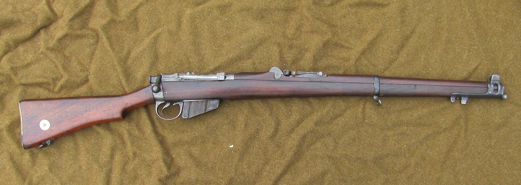

    Here's a similar rifle-- my 1907 LSA MK I ***. It's not all correct but has a great barrel and is mechanically very good. These are not often seen around here (Northwest U.S.)

    Thank you! That looks very nice indeed! Is it a "K" block??

    Quote Originally Posted by Salt Flat View Post
    Very nice looking piece.
