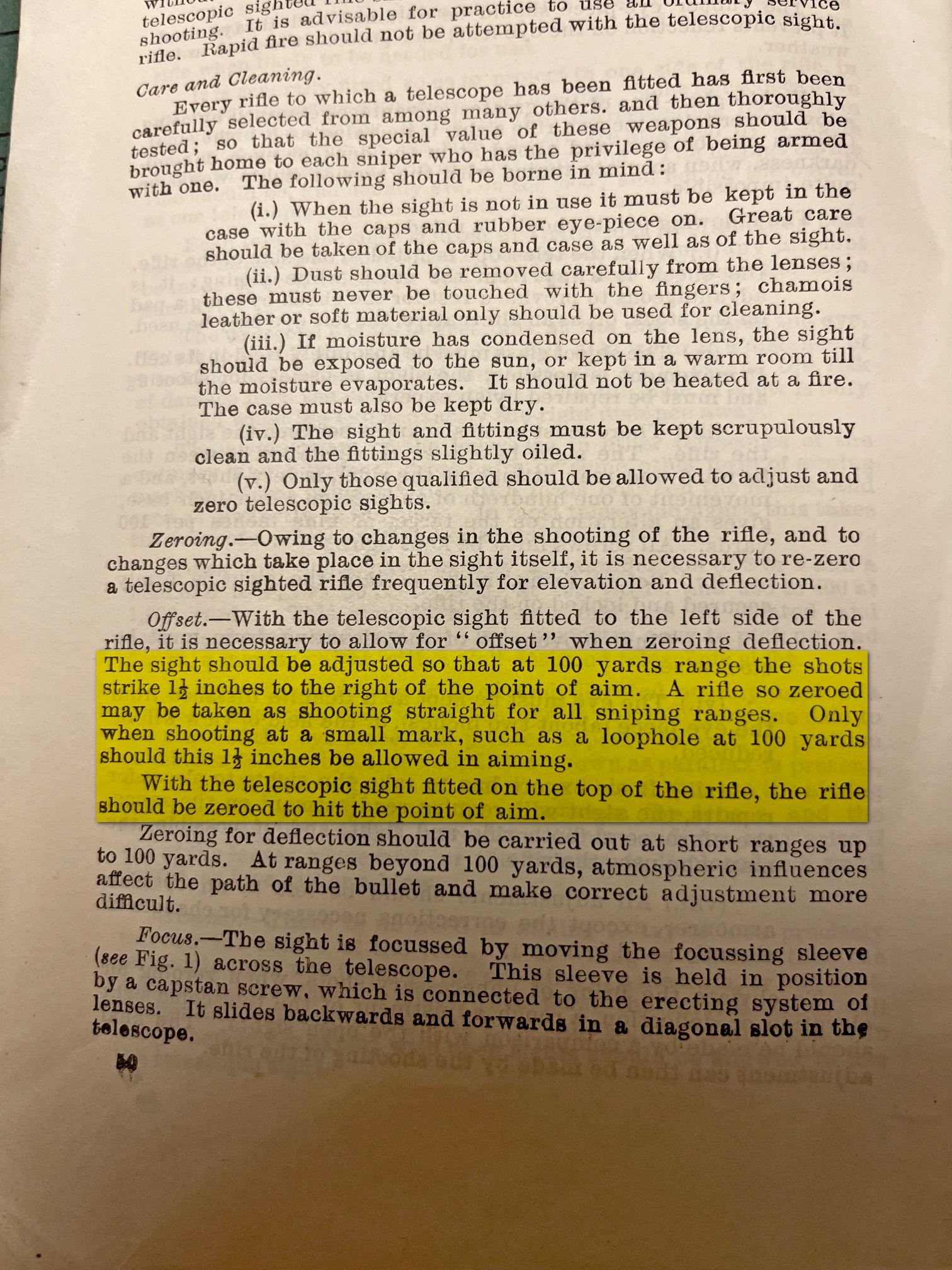

    The Sniping pam of November 1917 does say that (& this must be an approximation as various different types of offset mount systems were in service at the time) the scope & bore should be parallel, with the scope offset 1.5 inches to the left of the bore. This results in a consistent aim off at all ranges. I'm responding off the top of my head & can't remember without digging out the pam what it said (if anything) about the vertical plane.

    Against my lazier instincts I got up & had a quick shufty........see the para starting 'Offset'.....My words aren't exactly what is written but I think the general idea is the same.

    Someone blundered there and not just once. Rather stupid advice to suggest that 1.5" inches doesn't matter beyond 100 yards as 1.5" is about the width of a Germanicon loophole plate's aperture.
    The second paragraph contradicts the first and the paragraph below the two highlighted is a lot of rot as well.
    Odd the use of fine brushes is not mentioned for removing dust from lenses. Of course in the cold and wet of France and Belgiumicon condensation was the problem for most of year.
