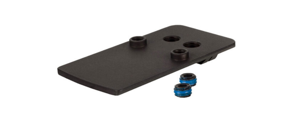

    Thank you. I expressed myself a tad unclearly.
    I meant something that would fit in the dovetail groove where the normal iron rear sight is installed.
    Something similar to this one.

    The IPSC fraternity would know in detail. Such a mounting would place it a bit high over the bore axis, muzzle flip and holes in the target lower than sighted as close distances, the same as for scoped rifles. If you shoot only occasionally with an optic on your handgun it should work fine for many years. For close up shooting at centre of body mass in low light it works excellently.
    Production optic division in IPSC started that way, with mounting plates in the rear sight dovetail. Machining the slide to fit the mounting plate is standard today.

    I went to my gun shop, but those mounting plates are specific for dedicated models of handguns. I was hoping that the dovetail would be enough…
    A tad naïf, I guess.
    They called my Bernardelli pistols “antiques”. They will ask if there is some chance to get the plates done for them.

    The Bernadelli isn't seen in IPSC or special forces, where optics are the norm. It is in another class, relatively small numbers. Think of thousands of rounds a month if you're active in IPSC. CZ, Tanfoglio, 2011 are the norm for optics and the fittings are mostly intended for them. There's a reason you don't find dovetail mounts for optics that easily, and why mounting plates are the norm.
    I would suggest the easiest and quickest way to get a dovetail mounting plate for your Bernadelli would be to have one machined to fit your gun's rear sight dovetail. A small light optic will work, there are many available in many price ranges. The cheapest should give you an idea how it works, might even last as long as an expensive one. The sight should fit in front of the dovetail to prevent the additional reciprocating mass being too far back on the slide. Check photos of optic ready handguns on the web to see where it should fit. The optic would then screw directly onto the mounting plate.
    I recommend you contacting IPSC Italyicon to find the club nearest to you. The club members should be able to direct you to a gunsmith who should be able to produce what you require. They will probably also provide copious advice and invite you to shoot optic guns.

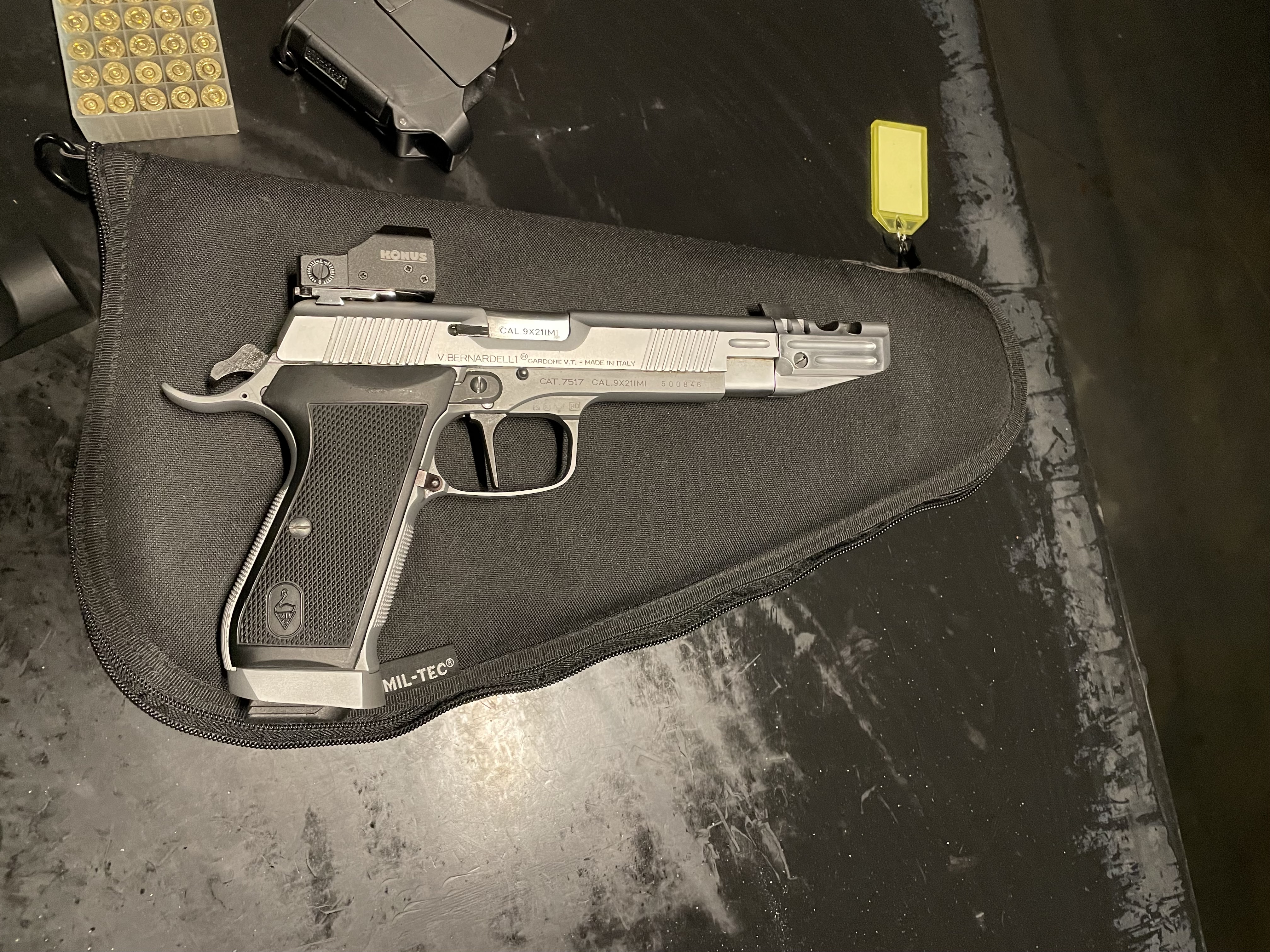

    Well, that is the result of adding a modern sight to a classical lady...
    I like it a lot.
    Now, I have to put some threadlocker to all the screws and start shooting with it.
