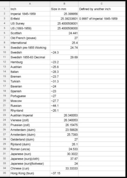

    It's in here Alan not the measurements but the conundrum !
    Indeed a well knowm problem.
    There are / were some 30 odd 'inches'. the Enfield inch is so close you wonder why they bothered.
Name:	Enfield Inch.png‎
