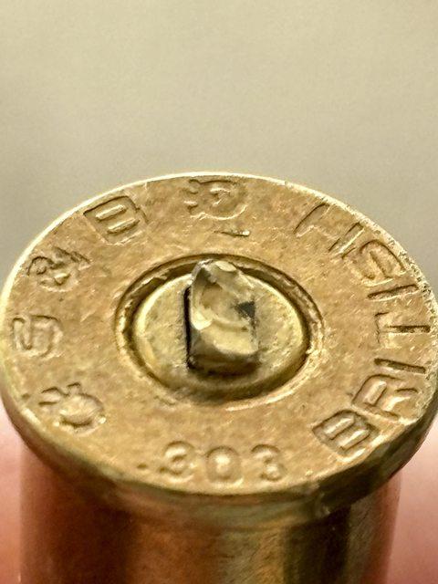

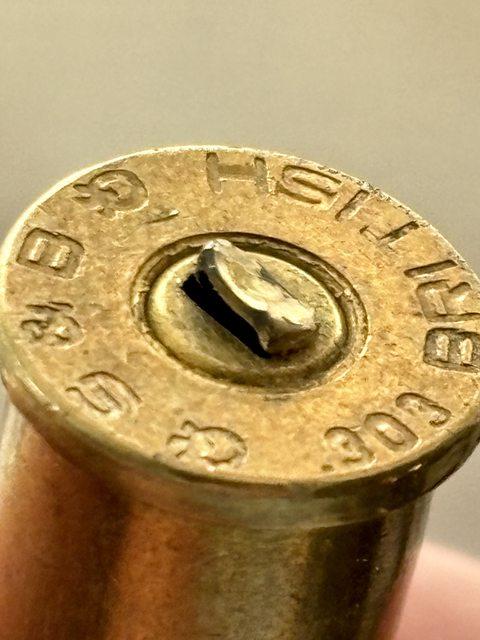

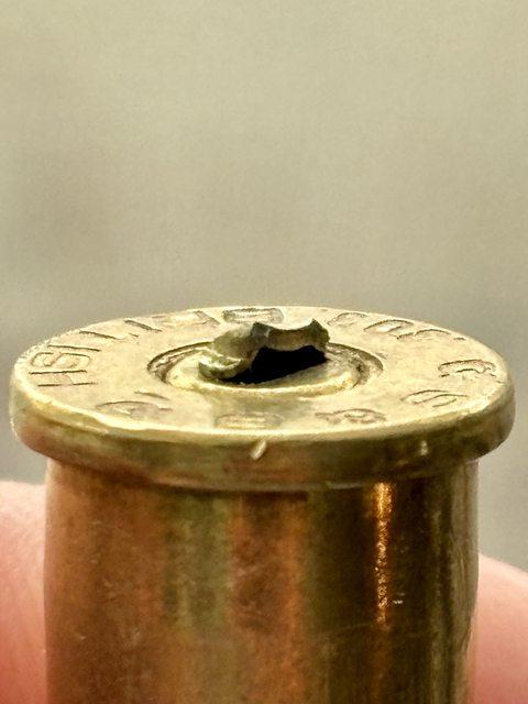

    Hi guys,
    Anyone have an idea for a solution to this issue?
    (It is a US civi-legal semi-auto Bren, using the striker system, not an open-bolt Bren.)
    I am using the recommended S&B ammo - Bren is cycling nicely but rupturing the primer.
    Thank you in advance for any suggestions.
    *I'm going to try out some surplus Brit .303 ammo, that has tougher primers, hopefully that is the fix. I'll also try it with some PPU ammo.

    We often equate that sort of thing to excess pressure in reloads, that's factory ammo isn't it? I always thought S&B to be at the very top of the pressure curve in it's loadings.
    Otherwise it would be firing pin protrusion, but there are guys here that can quote you what that should be off their noggen...

    Thanks Jim, this was 100% new manufacture factory Seller & Bellot ammo.
    Yes, I posted in several forums on this question, as I really don't want to damage the Bren, apparently you are correct S&B are hot loads with weak primers.
    I'm going to run some WWII Brit through it, and some PPU next week, heat that old barrel up and see what happens.
    Thanks.

    Perhaps the firing pin is insufficiently supported, allowing the metal to be blanked back into the firing pin hole in the bolt face.

    The Bren firing pin is designed to stake the primer in the pocket after firing to remedy the problem of backed out, spent primers jamming them during trials. I don't have much experience with S&B but guessing if you change ammo, the problem will go away.

    Never seen that with any Bren but caps-out was a problem until they solved it, as Brian says, by staking the cap in place during ejection and knocking the cxxp out of it, to distort it when firing.
    Could the striker hole be enlarged? Failing that, the answer must be excess pressure blowing back against a weak primer.

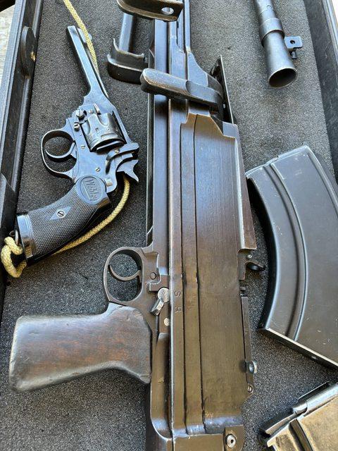

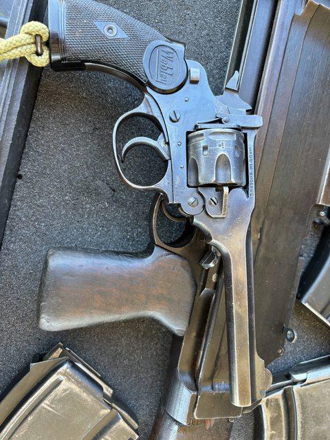

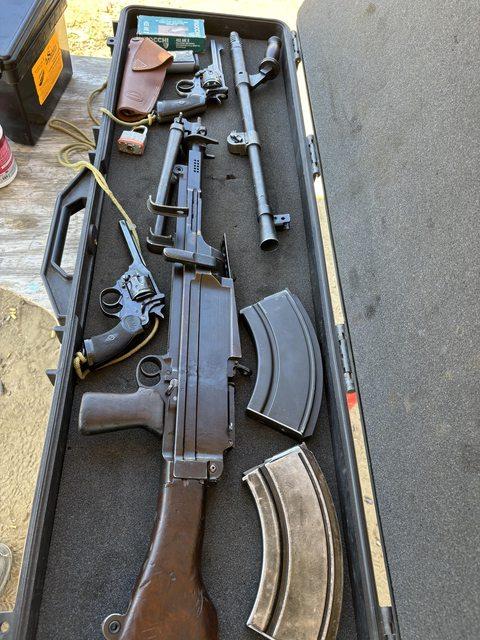

    Took The Bren MKII Semi out to the range again today.
    Ran three 15 round loaded mags of S&B through it, no pierced primers.
    However the last mag experienced a case separation, and of course I had left that particular tool at home.
    I bought 200 rounds of PPU, and some newer Britishicon military issue ammo to try, too.
    But, not another pierced primer.
    I shot my two revolvers for the rest of the outing, they were a lot of fun.
