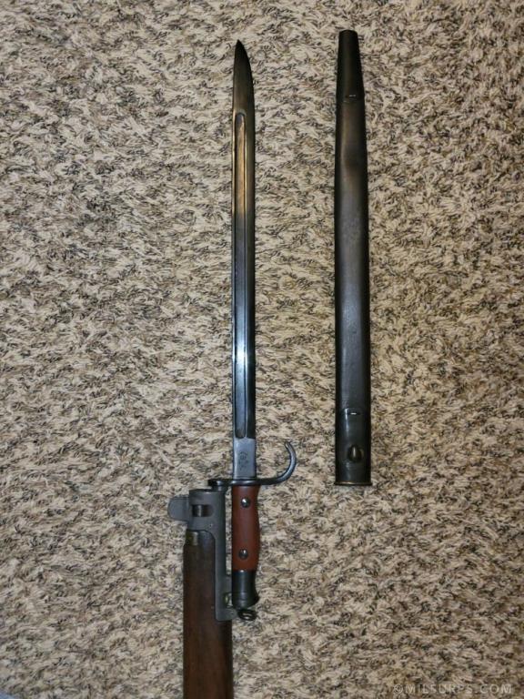

    My No. 1, Mk III rifle tends to shoot high at 100 yards. It is my understanding that the presence of a bayonet affects the height accuracy.
    Real 1907 pattern bayonets are rather scarce and expensive, but I noticed that Sarco has 1907 bayonets of modern manufacture, not original, for only $75 USD:
    https://www.sarcoinc.com/british-enf...with-scabbard/
    I went ahead and purchased one these and it appears to fit the rifle quite well:
    Both the weight and dimensions look correct. This should be adequate for my experiment. Once the weather improves, off to the range to try this out. Choice of ammo may also make a difference. In contrast to my No. 4 rifles, I achieved better results using 150 grain versus 174 grain bullets.

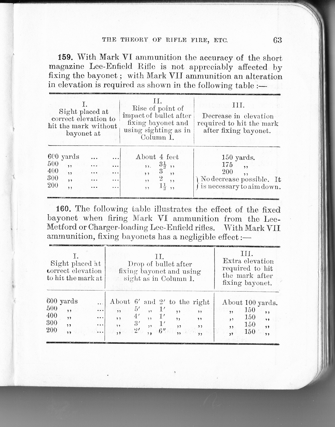

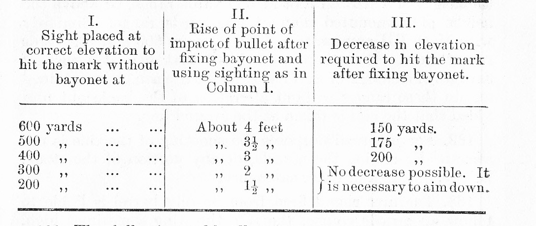

    Tests have been done and the results printed in the manuals (you just need to find the correct manual):
    Comparisons in the difference between MKVI and MKVII ammunition with / without the bayonet fitted :
    There are several pages but this is a good summary :
    Source :
    “Musketry Regulations Part 1”
    1909 (With Amendments 1914)
    Issued by the General Staff – War Office.
    Summary :
    With a SMLE & with MkVI ammunition there is no effect to the POI when the bayonet is fixed.
    With a SMLE & with MkVII ammunition there is a 4 feet Rise in POI at 600 yds when the bayonet is fixed.
    With a Lee Metford, or CLLE there is a 6 feet drop, and 2 feet to the right change in the POI at 600 yds when using MkVI ammunition with the bayonet fixed.
    With a Lee Metford, or CLLE there is a negligible effect in the POI when using MkVII ammunition with the bayonet fixed.
    YES – that is correct – with the CLLE / Lee Metford the POI is NOT AFFECTED when using MkVII with the bayonet fixed, but with the SMLE the POI is NOT AFFECTED when using MkVI with the bayonet fixed..

    Finally got to the range. I can conclude that the inclusion of the 1907 bayonet made no difference whatever in accuracy. The Brits said it wouldn't and it didn't.
    However, I discovered something else. I spent some time comparing my recently acquired No 1, Mk III* Enfield to the No 1, Mk III BSA. The Mk III* is a bit of a hybrid in that I suspect the stock is an Indian replacement. At 100 yards, it shot very well, measurably better than the Mk III. I wonder whether something is not setup right with the Mk III. I understand that there is a spring loaded screw at the nose cap and another right after the rear sight that might have something to do with this. Any adjusting advice?
