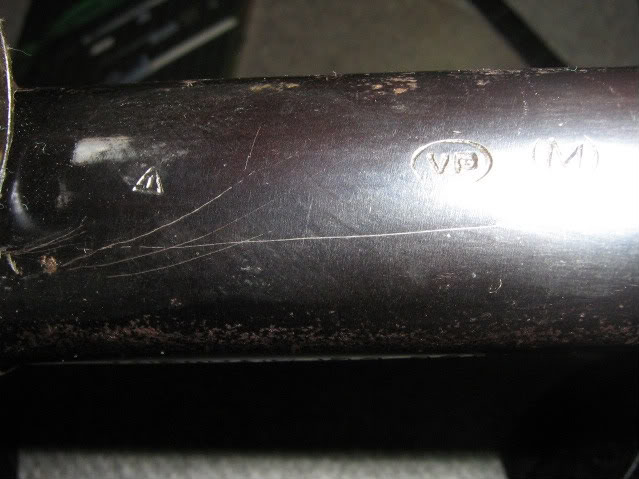

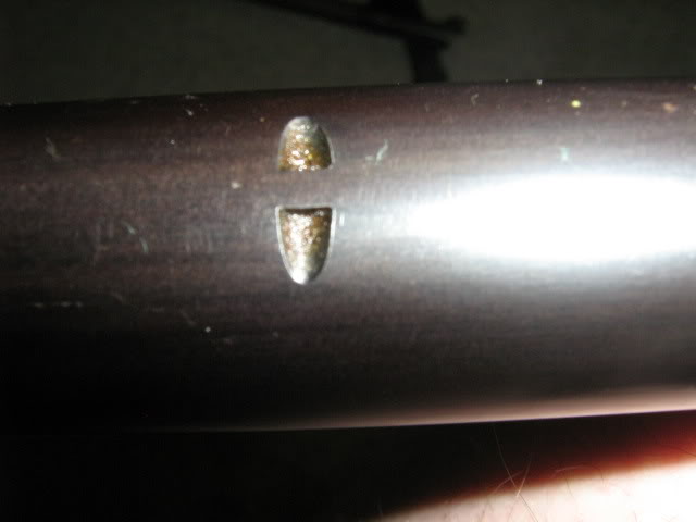

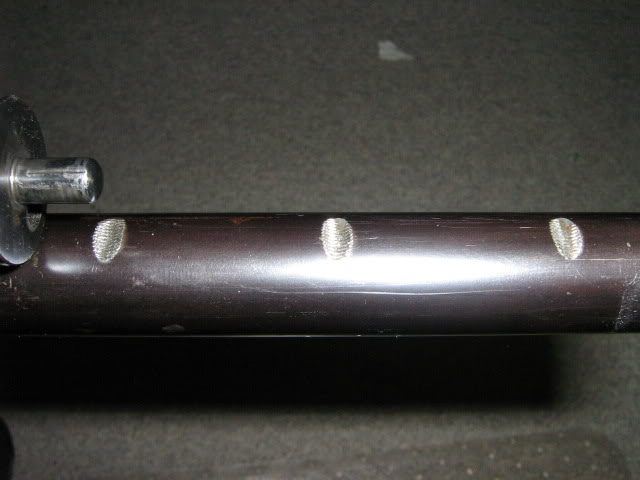

    Here are a few more pictures... Is there anything else you need or would like to see photos of?
    Underside of barrel near muzzle:
    Markings near breach on underside (L to R = 1 in triangle, VP in oval, W or M in Circle):
    Underside of barrel near the end of the mag tube:

    Looks like you have a Commercial Trench Gun, made in the 1930's for Civilian and police use. The police markings on the barrel are most likely authentic, and the absence of any Military markings support that it was a civilian gun. It has a left over WW1 vintage handguard, evident by the "Pat Appl For" markings on it, which is common for a gun of this vintage.
    It looks like an honest Trench Gun with even wear on it, but not a military issue gun so the value is much less than if it had a nice "U.S." on it
    Hope that helps you out.

    Do the commercial M97 trench guns have the two notches on the barrel for the barrel/mag tube band screws? I don't think any of my Military M97 trench guns do. Maybe someone with a commercial trench gun knows for sure.
    And the notches on the barrrel for the bayonet adaptor don't look 70 years old to me.

    A commercial gun in that serial range will most likely have a 2-digit date on the barrel, right above the mag tube close to the receiver.

    Quote Originally Posted by Sgt Rock View Post
    Nothing else on the barrel but what I showed in the pictures.... no date

    Looks like a later vintage riot barrel to me. The mag band 'pinch' marks and filled in sight bead hole are evidence thereof. Looks like the barrel protrudes a little far past the end of the handguard assy. also.
