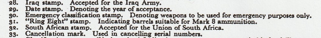

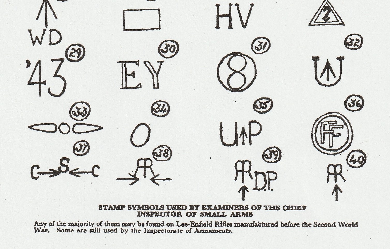

    It is interesting to note that Lee Enfields that were authorised to use Mk8 (NC) ammunition had the barrel marked with an "8 in a circle"
    See example #31
