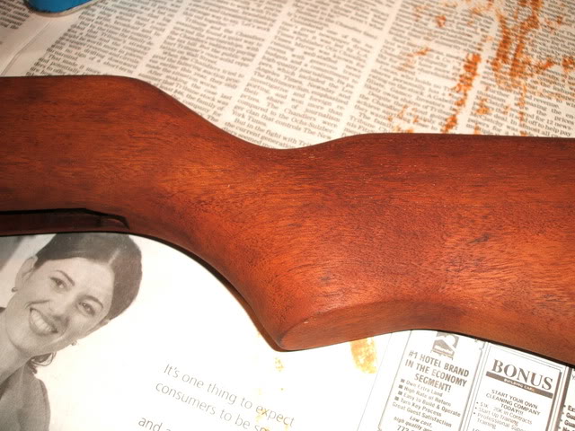

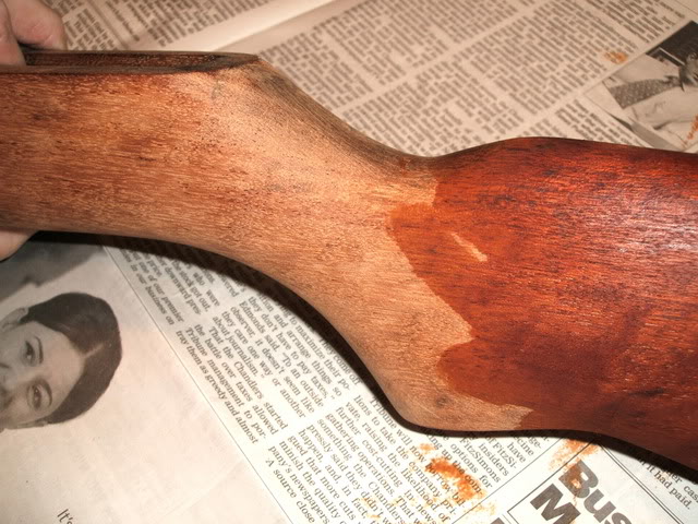

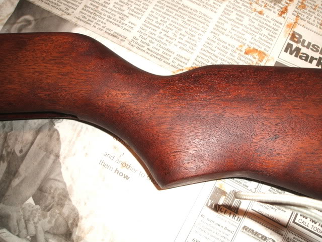

    I have used Chesnut ridge and Vanderhave's from Brownells
    This is the Chesnut Ridge applied to a post war Philippino Replacement stock. The wood was said to be Mahogany
    Dye going on
    Dyed
    Oil going on
    Cured
    If I want a lot of control of the color I will let one coat of Tung Oil finish cure first and then use the dye. It allows me to go back and pick up some dye with an alcohol moistened paper towel if I want.
    JR
