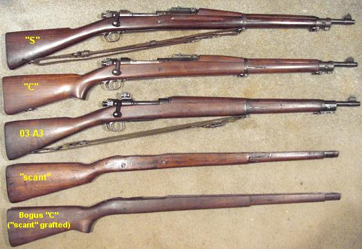

    Nevermind, I found a great page detailing all the changes in the stock through the years. http://www.trfindley.com/pgm1903stkid.html

    Too bad he didn't steal the original version of my picture -

    wow. i see alot of highjacked pictures from Joustericon on his page, wonder if he even had the balls to ask??

    Even more importantly is he has a bunch of pictures to copyrighted material on his website. To top things of he humps up stocks (I mean restores cartouches)!!

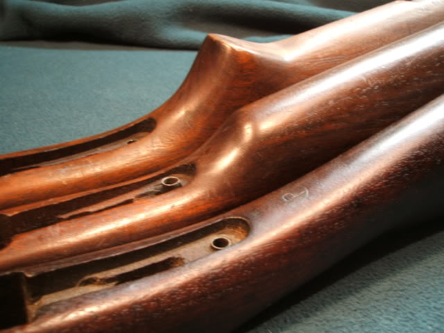

    For one magic moment I had three just laying there so I preserved it.
    Keystone C, Scant and Grasping groove
