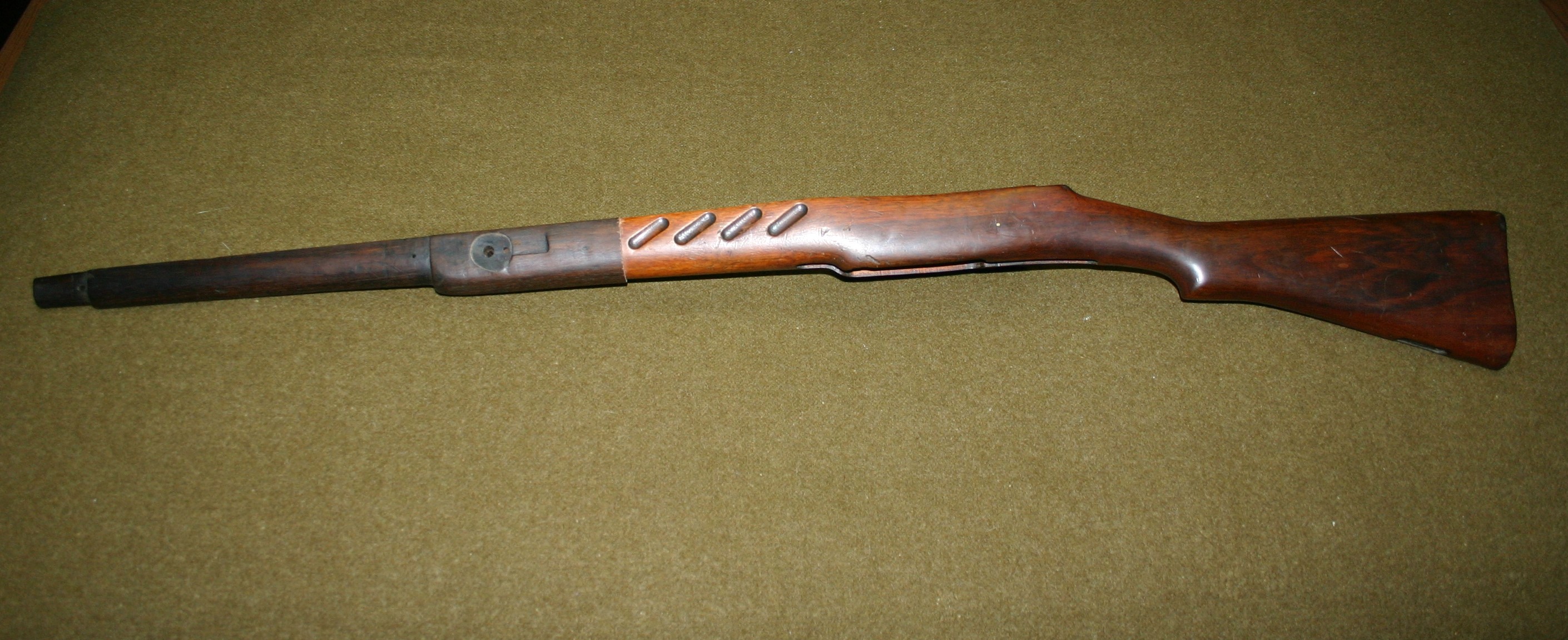

    So lets start from the beginning.
    This is the rifle when i purchase it.

    Step 1 ... evaluate the rifle and see what needs to be done and what is missing.
    - The rear sight ears were cut and had washers welded into place... so new ears have to be fabricated.
    - The stock needs to have a front portion spliced and new hand guards fabricated
    - The barrel is some kind of after market replacement in 303 that is not even of the right profile... a new one is needed.
    - The rear sight is missing altogether... a new one will have to be made by modify one from a P14
    - The front sight assembly is also missing... again a P14 one will be modify
    - The volley sights, missing... easily modify from a Lee Enfield one
    - The nose cap and screw are long gone... modifying a P14 might be possible, will see...
    - The bands are MIA ... P14 bands look exactly the same.
    Of course some of the repairs and/or fabrication might not be 100% correct but with a little bit of effort it should end up ''looking the part'' (no pun intended)
    Sounds easy enough.....

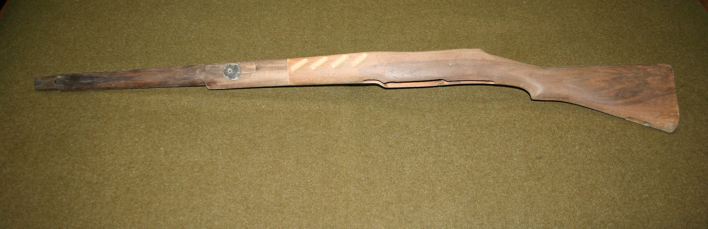

    Step 2 ... See if what is left of the stock can be repaired.
    To me that project is as much about preservation as it is about restoration... meaning i want to save as much of what is original as possible.
    So saving the 1/2 stock i have is a must... that leaves me with the option of splicing a front part to the chopped P13 stock.
    The wood was sanded but not too badly ... everything behind the distinctive finger grooves is salvageable.

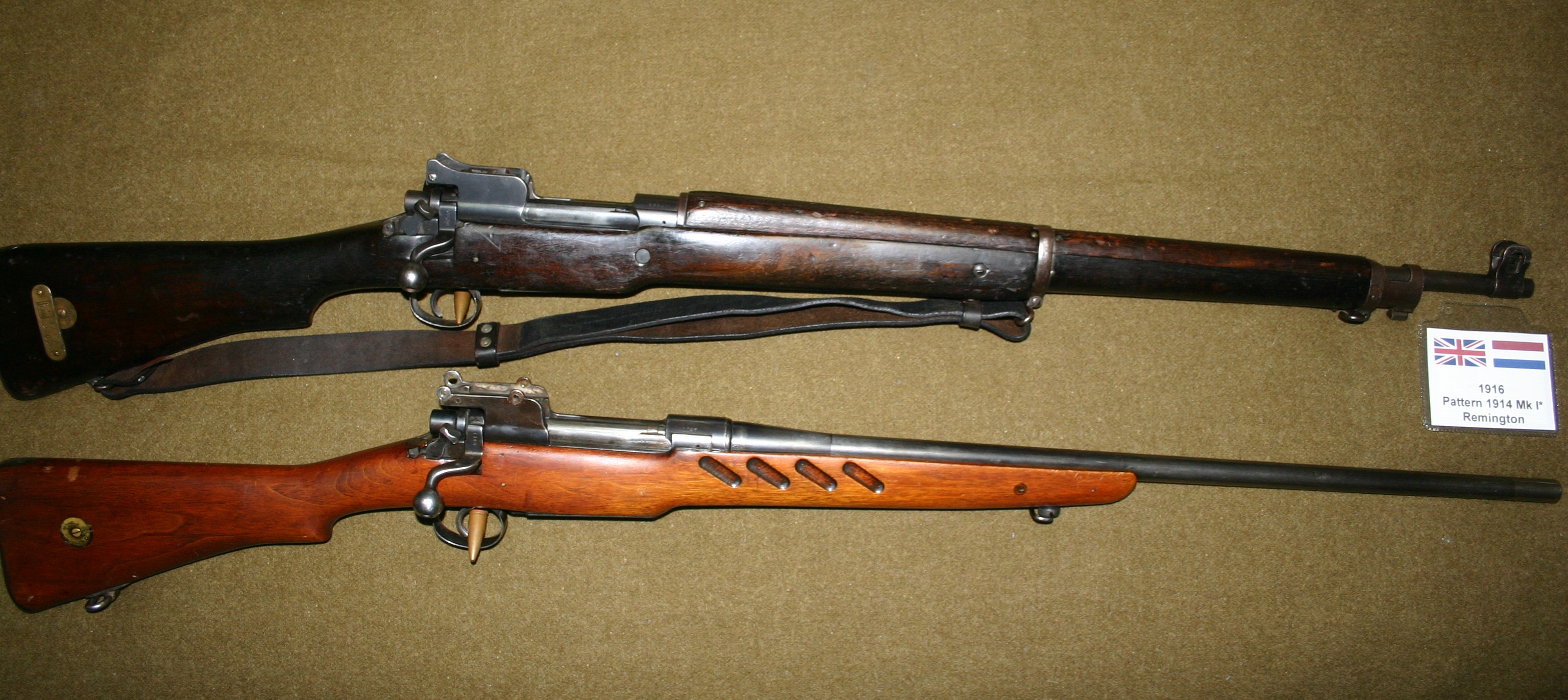

    Here's an original Pattern 1914 next to the P13

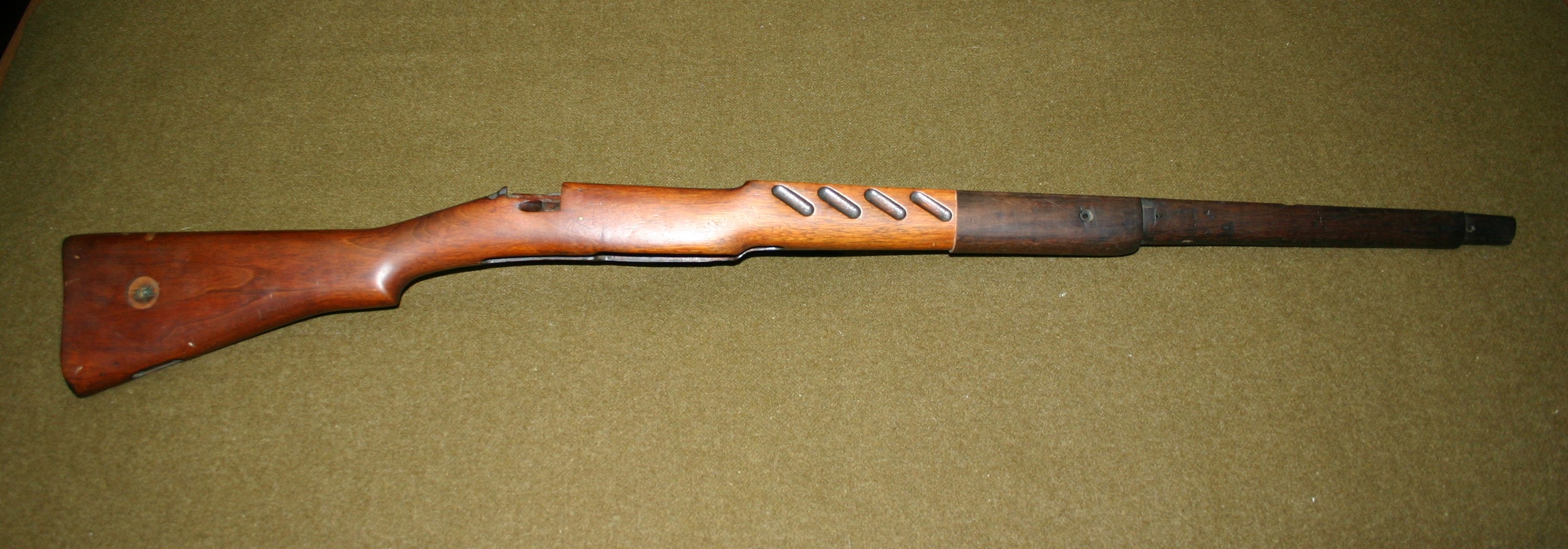

    Here's another one which somebody made into a Match Rifle

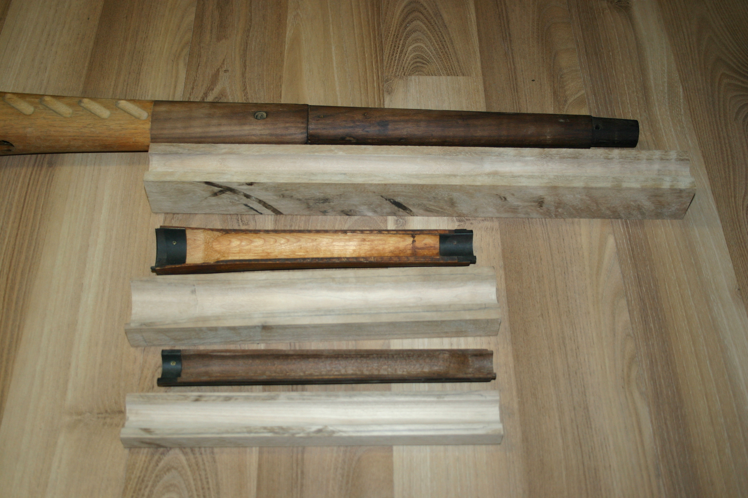

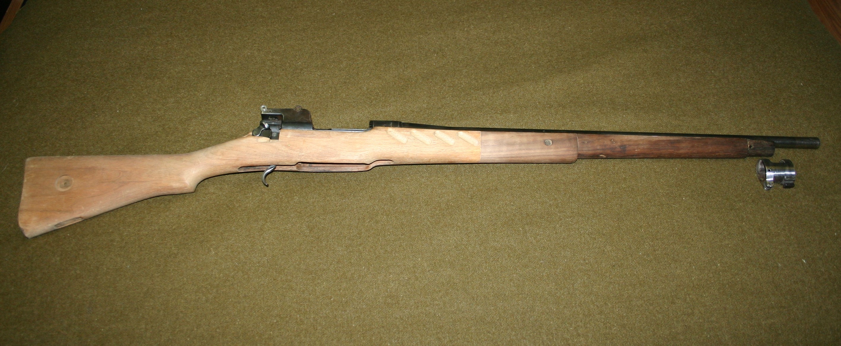

    Ok more pics of the ''progress''
    You guys know the old saying... one step forward, two steps back... well this was one of those times.
    Since i know my way around working with wood a little i figured i would start with the stock.
    After determining that a P14 stock was pretty damned close to the P13 i went about and searched for a replacement.
    I got lucky and found a non matching P14 in one of those deactivated stock set (the one with two huge holes on each sides)
    This was perfect... it would provide me with the ''ears'' (i'll explain later) the new barrel, the front wood, the handguards and all the metal bits needed.
    This was obviously a ''bitser'' and i had no remorse's in taking what i needed from it.... i also got it for very cheap.
    I cut both stocks and spliced them together.
    The P14 wood was very dark... i knew from the start matching wood was going to be almost impossible so i was ok with that.
    Stain would have to be used.
    Turned out not too bad
    (or so i thought)

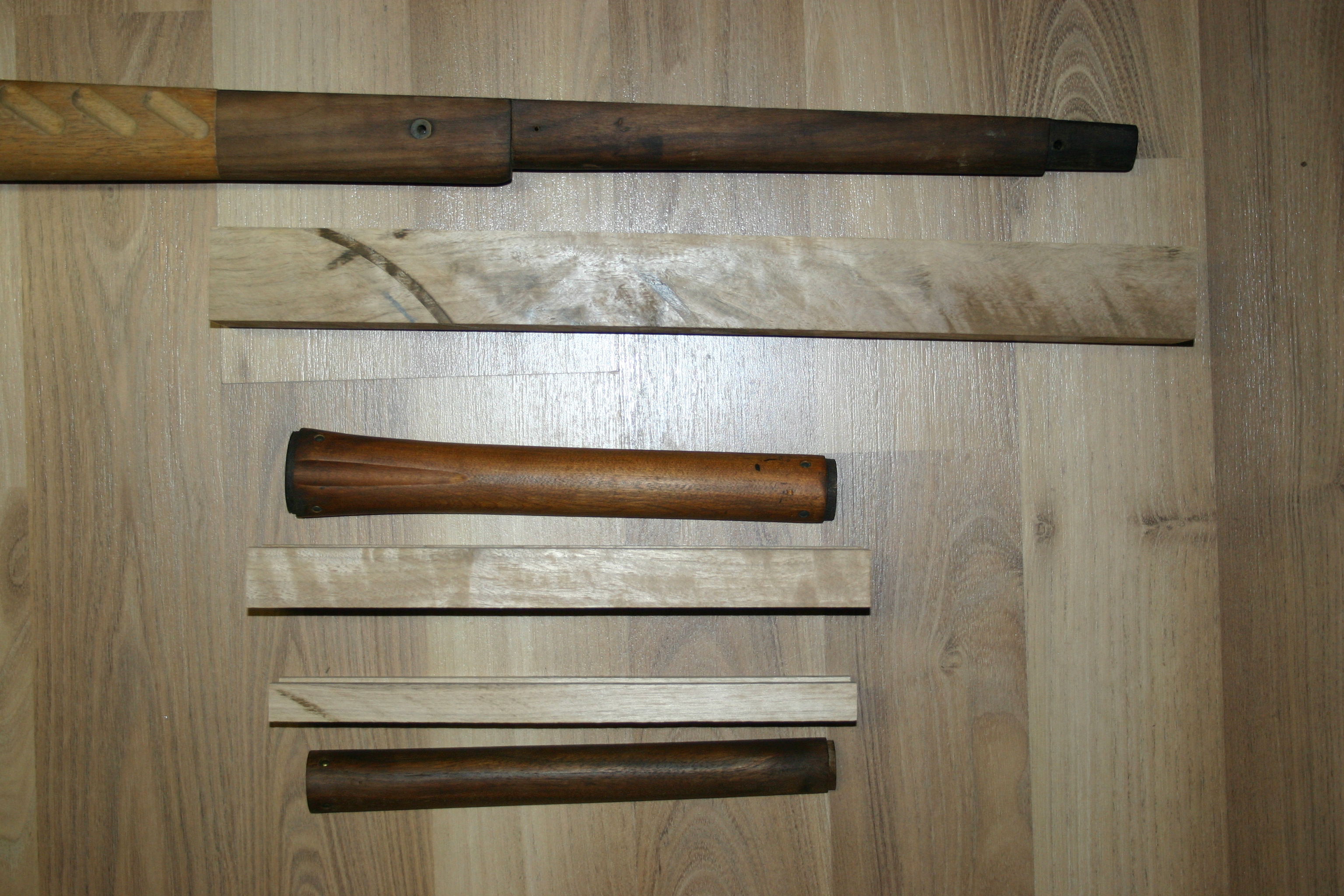

    So after thinking about it i decided to make the front part and handguards from scratch.

    I've just had a very good laugh when I scrolled down here and under the field where I enter my post the forum suggested a similar thread. The title reads " Restoring a sporterized P13...". I couldn't remember that thread, so I clicked - and guess what, it is your particular rifle here, but in 2013. And back then it had a scope sitting in these "rings" on top of the receiver. See yourself here: https://www.milsurps.com/showthread.php?t=46367
    Secondly, I once did a picture comparison of the P.13 and a P.14 rifle. You can find these pictures in the Knowledge Libraryicon in the entry for the P.13 rifle, or directly here: Pattern 1913 "Trials" Rifle . If you need any additional images or better closeups, let me know.
    Finally, I think the toughest part will be replacing the barrel with one in the original caliber, plus the rear sight will be an impossible task since "conversion" of a normal P.14 won't do it. Maybe you should consider leaving the rifle in .303 caliber, use a normal P.14 sight and just shorten it enough to be of fitting length to the receiver bridge. For what I know there were trials done of the P.13 converted to .303 Britishicon caliber, so you wouldn't be too much off with that. Also note the "ears" of the P.13 and the P.14 rifle are of different shape. Maybe you would do better by not cutting off the "ears" of the P.14 receiver, but rather get new parts of correct thickness and shape laser cut and then weld them to the receiver.
    I searched all over for pictures and i don't think i've ever seen yours... they are great, many thanks i'm sure they will prove VERY useful.
    Having shots of P13 and P14 side by side is invaluable... next to having the real thing of course lol
