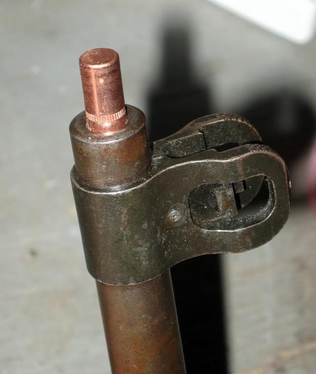

    Thanks for all the suggestions guys. I need to come up with a lead bullet to try running down the bore. I'm really leaning toward the crown at the moment. I've ordered some muzzle laps and a couple of grades of grit. We'll see if that addresses the situation.
    Here's a 180g CoreLokt at the muzzle:
    Here's the muzzle itself. When I look with a loupe, I can see a burr:

    IMHO it looks like you might need to have it recrowned and head space checked.

    Quote Originally Posted by joem View Post
    Other than general principle, what makes you suggest checking head space?

    I seriously doubt that muzzle is causing that big a problem. If the bore looks good it probably isn't causing that huge a problem either. Even a shot out rifle will not be that bad at 25 yards. I wish I could tell you what IS causing trouble but it would be a pure WAG. You might try to contact the seller and he might shed some light on the issue. What kind of ammo are you using?
