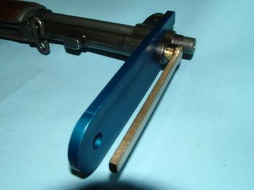

    These parts were meant to be assembled dry. You do not need thread lockers or never sieze compounds. You just need the proper tools. These can be purchased through Fulton Armory and others.

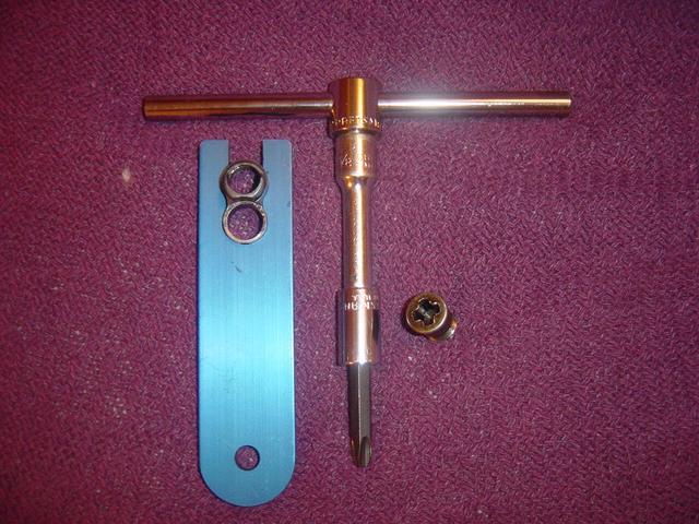

    I use a similar set-up to above for removing frozen gas lock screws.
    3/8" T-Bar, Extension, and Phillips socket are Craftsman
    The gas lock wrench should be in everyones kit in my opinion.
    +1 on a drizzle of Kroil Oil if the screw just won't budge, let it sit and soak for a half hour and then try.
