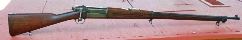

    Took my new (old) Kragicon to the range today for the first time.
    Fired several handloads that I tried to keep on the mild side, both for the rifle's sake and my shoulder's. Shoots great. Made several different loads out of components I had on hand. IMR 4320, resized .303 brass, 180 gr. and 150 gr. spitzers. Best result was had with 35 gr. of powder pushing the heavier bullet. At 100 yds. I kept 3 rounds within 1.6" and 2 rounds went over the paper (I attribute that to the shooter). The group was about 8" high which I expected due to the 300 yd. battle sight. The rifle is obviously capable of shooting much better than me.
    Now that I know the rifle is a shooter, I need some recipes. I have used up the 4320, so will be buying new powder and I have also obtained some .30-40 brass. What do you guys shoot in a 150 or 180 gr. spitzer that will group pretty well at 100 yds? This will not be a hunting load, just killing paper. I know the rifle is designed for a 220 gr. bullet, but they are hard to find and I have a good supply of the smaller stuff on hand.
    BTW, this is a full military version with the 30" barrel and 1896 rear sight.
    Thanks
