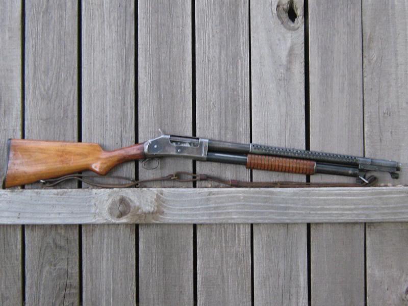

    I have a W97 thats had it's barrel chopped to 20 in. at sometime in it's life. Am considering making an artificial trench gun out of it. Will the heat shields fit on cut down barrels? What is the correct lenght? Some sources say 20in. and some say 20 5/8 in. Could someone with an orininal measure the length and tell me?

    ...bbls are tapered. Trench bbls are straight. The ID of the adapter will be greater than the OD of your cut down bbl. A sleeve would have to be added to take up the space and give enough "meat" for the screws to "bite" into. The bbls are 20-inch

    Here are the dimensions of the barrel on mine(including the relief cuts for the heat shield bayo mount).
    You would also need this end cap.
    Here it is beside a standard shotgun.
    Here are the barrel stamps.
