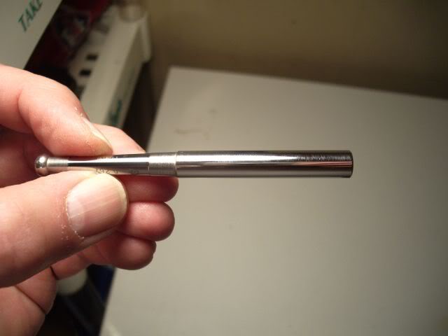

    Below is a Canadianicon .303 bore gauge that fits my 1950 Long Branch perfectly, it does not fit Britishicon made barrels.
    (silly barrels must be metric)
    The bullet test is meaningless unless you know the exact size of your bore and the exact size of your bullet and place it in base first.

    Boom-Boom
    1. I bought this bore gauge at a Britishicon website along with a firing pin protrusion gauge and a stock collar (trigger guard bushing) measuring gauge and filing jig, they are no longer available.
    2. It is not a throat erosion gauge and graduated for throat wear.
    3. The Canadianicon bore specifications are listed below, this gauge is .303 diameter and fits the Long Branch bore, it does not fit in a British 2 or 5 groove barrel.
    4. All the tools and gauges mentioned above are Canadian military manufacture and were used by Canadian Armourers.
    All the information below is from Badgers “Lee Enfield On-line Knowledge Librariesicon (Index of Articles)” at the top of this web page. I donated all these Enfield manuals that NO ONE READS, the gauges are pictured in illustrations in: 2002 No.4 (All Marks) .303 Rifle Manuals (Complete Set)
    2002 No.4 (All Marks) .303 Rifle Data Summary
    http://photos.imageevent.com/badgerd...%20Summary.pdf
    Bore Diameter . . . . . . . . . . . . . . . . . . . . . . . . . . . . . . . . 7.65 to 7.72 mm (0.301 to 0.304 in.)
    Number of Grooves . . . . . . . . . . . . . . . . . . . . . . . . . . . . . . . . . . . . . . . . . . . . . . . . . 2, 5 or 6
    Rifling . . . . . . . . . . . . . . . . . . . . . . . . . . . . . . . . . . . . . . . . . . . . . . .1 turn in 25.4 cm (10 in.)
    Direction of Twist . . . . . . . . . . . . . . . . . . . . . . . . . . . . . . . . . . . . . 2 and 5 grooves - left hand - 6 grooves - right hand.
    Barrel
    Plug Gauge, GO 0.3009 in. . . . . . . . . . . . . . . . . . . . . . . . . . . Shall run through the bore.
    Plug Gauge, NOT GO 0.307 . . . . . . . . . . . . . . . . . . . . . . Shall not run through the bore.
    Plug Gauge, NOT GO 0.308 in. . . . . . . . . . (1) Shall not enter the bore at the muzzle end
    more than 6.35 mm (1/4 in.); and (2) Shall not completely enter the chamber at the breech end.
    Plug Gauge, NOT GO 0.310 in. . . . . . . . Shall not enter the chamber more than 6.35 mm
    (1/4 in.) beyond the etched line.
    Tapered Plug Gauge . . . . . . . . . . . . . . . . . . . . . . . . . . Shall not enter the chamber more than 19.05 mm (3/4 in.).

    Please note my .303 diameter gauge is not listed in the manual above and could have been used for the .308/7.62 barrels.
    Also note what you are looking for on the .303 Britishicon Enfield Rifleicon is a .308 diameter bullet to check bore muzzle wear.
    Plug Gauge, NOT GO 0.308 in. . . . . . . . . . (1) Shall not enter the bore at the muzzle end more than 6.35 mm (1/4 in.)
    NOTE: Gauge requirements may differ in country of barrel manufacture.

    Just a minute Ed......, I WROTE huge parts of the L2A3 Sterling and L4 Bren EMER............!
    As for the No4 muzzle wear, then we say the GAUGE, Armourers, plug No2 .308" diameter No2 MUST NOT enter the muzzle by more than .25". If it does, then the barrel will be rejected and condemned. Even when the barrel rejects the gauge, where it (the barrel) is suspect, it will be range tested for accuracy and rejected if it fails.
    The long and short is it will be rejected if it fails the accuracy test and/or the No2 .308" gauge
