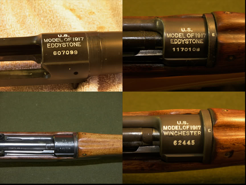

    I am willing to bet its a P14, if it is, you will see the makers mark and the serial number on the receiver ring with no other writing. The P14 makers mark was W for Winchester (stamped as the first character of the serial number), ERA for Eddystone and RE for Remington whereas the M1917 had the makers name spelled out. (except very early Winchester were still marked W.)
    (below is what the M1917 receiver ring looks like)
