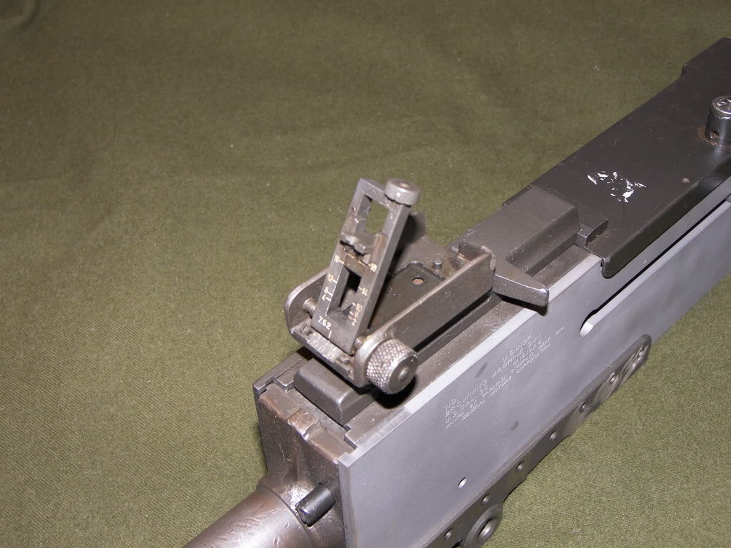

    Sounds like a 1919 sight as well, did it look exactly like the #4 sight or just similar?
