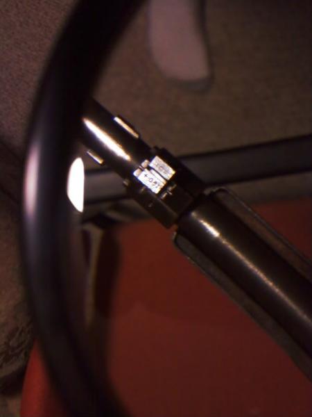

    Front sight
    From the Lee-Enfield Rifle Website
    All Lee Enfield's utilized a dovetailed, blade type, front sight. (Note: SMLE and No4 front sights will not interchange because of different dovetail dimensions) There were nine different front sights available and were marked on top of their base with their sizes. They were: .090, .075, .060, .045, .030, .015, .0, -.015 and -.030
    Mine is different,it is stamped ROF +.031
    I know that is almost no different than .030
    They probably could not find the zero and used a 1 instead.
    Any other explanations?
    Please excuse the picture, I tried using magnifying glass for better view.

    .031 is a Bren gun! I never knew that they would interchange. I think that the foresight block on your rifle has been bubbad to accept it but I could be wrong

    It looks as if nothing has been altered.I'll will need to get some correct ones when I get ready to sight it in, after I get through restoring the Maltby.

    Jojoevo, what type of fore sight base is on your rifle? The one w/ the screw in front or the solid?

    Solid

    The sight base is stamped N67 on the front,I know that it was made by Singer Manufacturing Co. Ltd ., Clydebank.
    The rear of the base is stamped with Roman Numeral II, would that make it a Mk2 Block,Band.
    The Blade is Dovetailed with a slot.

    Looks like you're stuck looking for sights w/ the split dovetail, then. I've seen plenty of "incorrectly" installed split bottomed sights in the screw clamp foresight blocks, but it doesn't work at all the other way.

    I don't have the screw type foresight base,it is the solid.
    Which sights are correct for my foresight base?
    Why am I stuck with the split dovetail sight?

    Short new answer (because I can't find the old one):
    Putting a solid foresight in your solid base will enlarge the base's dovetail so that the sight will, sooner or later, come adrift. This is also from Captain Laidlericon, who knows plenty more than me!
