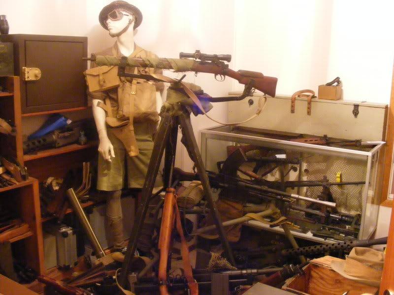

    I am sure someone will post a better shot of one, and since I won't be home for a while here is the only photo I have. If you look in the glass case, and squint a little, you should be able to see the launcher on one of the FNs.

    Hey Stencollector, that's quite a gunpile there. How do you get around in that space??? Or do you just sit in the middle with a glass of scotch and look around you? You are on the right track with the grenade launcher. I was infantry and we used lots of them. They fit on the flash eliminator like a bayonet. They enclosed the flash eliminator and were ten inches long. Same size around as 303 launcher. Black with a fold up sight(that wasn't much use). I don't remember them being UKicon marked but they had the Canadianicon Arsenels mark on them. The cartridge was C33 balisite which was the powder used inside. It was a open mouth case like an empty and had a black ring at the open end. The end was slightly rounded in for hand feed and DO NOT mistake it for blank. I fired one to get rid of it with a BFA on and damaged my rifle enough to send it base line repair. I was only 17. I know better now. I was told the 5 round mags you encounter were for the C33 cartridges. We used the launcher until we handed in the F.N.s in 1986 or so. The grenade you speak of was never used by me or anyone I knew of.

    Re: the gun room, it has reached it's limit. I picked up a Vickers and tripod last summer (dewat), and had to leave them out in the shed. I may try to do a re-org in there this summer, but you can only get a square foot of stuff into a square foot of space. I am thinking racks up the walls, but even that won't get the tripod mounted guns off the floor.

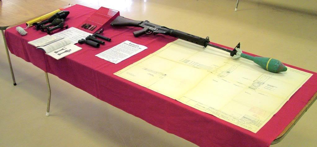

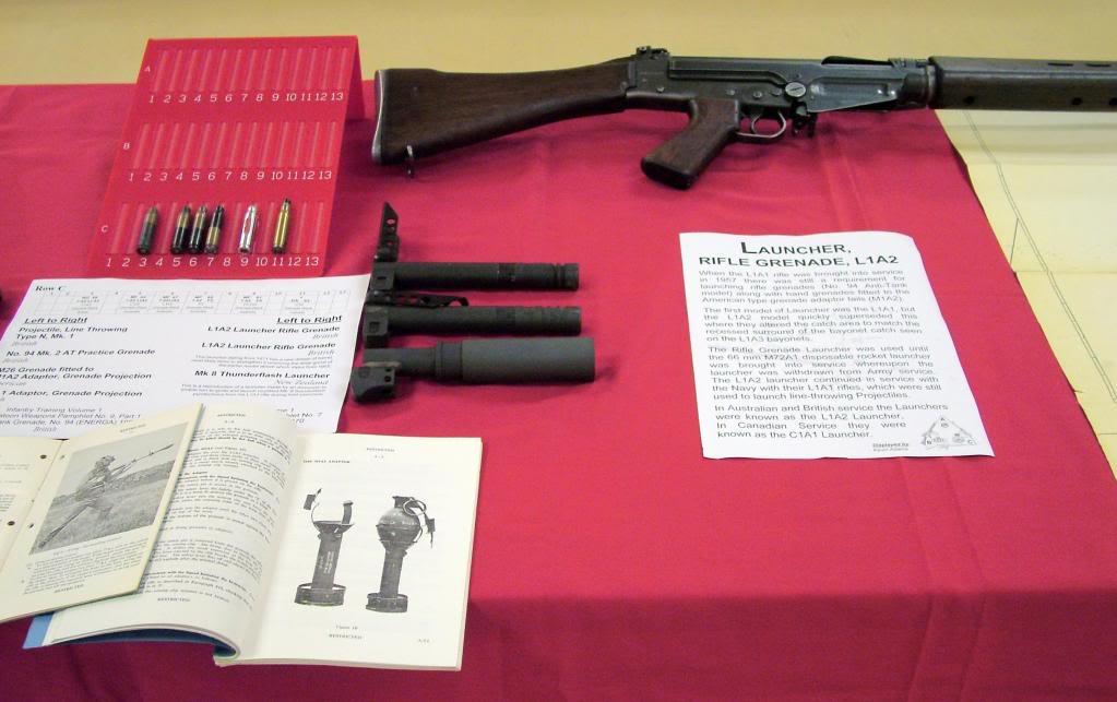

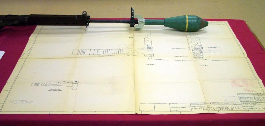

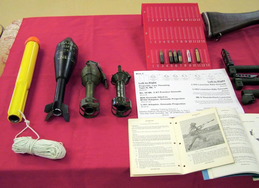

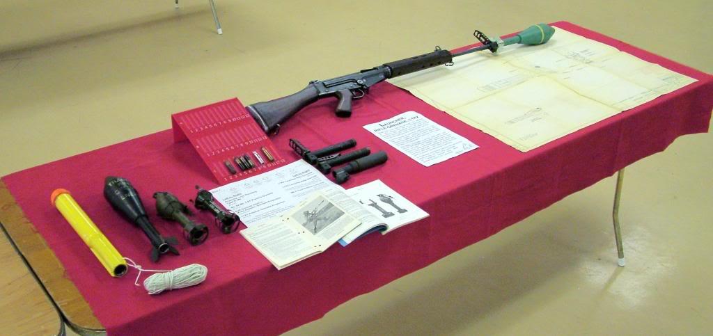

    The Grenade Launcher used by Canadaicon, Australiaicon New Zealand etc with their L1A1/C1 rifles were purchased from the UKicon. These were of course the L1A2 Grenade Launcher NSN 1005-99-960-0263.
    The Launchers were basically removed from frontline service once 40mm grenade launchers and LAW type weapons became common place.
    In New Zealand service the Grenade launcher continued in service with the Navy for line throwing up until the mid 2000's when finally the SLR was replaced as the ship's safety rifle by the Steyr AUG A1 rifle.
    From a gunshow display I did last year:-

    Pic 1, That's the launcher, pic 3 #11 cartridge is the one we used and the tailfin assemblies were the ones I spoke of. I never did see the chrome drill cartridge however. I wouldn't mind one of those for my collection! We did however have M72s and grenade launchers at the same time. When we changed to the M67 round grenade and the V40 grenade they couldnt come up with effective tailfin assemblies so the launcher went the way of the do-do. The fuses burn time were also getting shorter so they weren't feasable.
