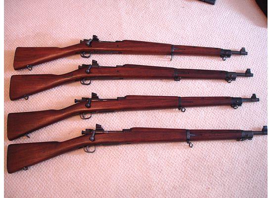

    Legacy Member MJ1's Avatar
    Sep 2007
    08-26-2024 @ 04:52 PM
    Guanacaste
    739
    05-05-2025
    01:11 PM
    Talking Blo
    PeteDavis's Avatar
    05-16-2012 @ 08:26 PM
    Mountains of old Virginia
    101
    05-05-2025
    04:11 PM
    MJ1-
    Nice rifle, tell us about it.
    PD
