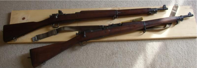

    The MKI and the Smith Corona arrived at my FFL dealer today. Before they went into the safe for the obligatory 10 day "cooling off" period, I got a look at them.
    The bore on the MKI is sharp, shiny and gauges a "1" on the CMPicon muzzle gauge. Barrel is marked "SA" and is dated 11-19. It does not close on a Clymer field gauge.
    There are cartouches on the stock and I'll post pictures of same when I get it in 10 days

    I picked up the 1903MK1 today, along with the S/C 03A3. A few pics:

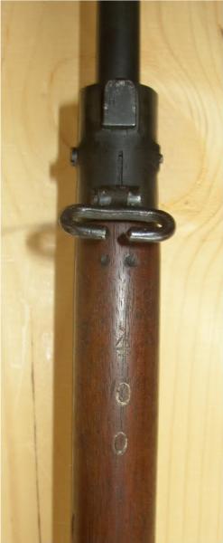

    A flaming bomb, just forward of the trigger guard

    Upper Band Cut
    Nice rifles Cal. I noticed the upper band on the Mark I has a cut in the bottom. I also have one of these on a rifle. I remember reading, maybe Poyer, that this was for use in bayonet practice, to screw the band tight to the stock. Is this correct?
