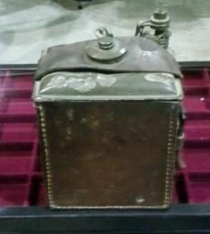

    bren gun oiler
    Just got back from the easter gun show in Calgary. Saw this at a table. labelled as a bren gun oiler. "buffer oil" scratched into leather. Manufacturer tag -(someone in Montreal-just glanced at it) under strap buckle.
    contact Odakim.net - Home of Shoulder to Shoulder Collectibles if you're interested-I think it was priced about $75.00
    I've got nothing to do with them , just thought someone might be interested.

    It certainly ain't like any Bren bit of kit that I've ever seen. The Bren buffer was just a simple split friction ring and it wasn't oiled after assembly but greased with graphite grease before assembly.

    Vickers oiler....check the date on the can under the leather...

    This is a standard Oil can for Britishicon Mortars. A company i used to work for had to obtain one for an overseas order. If you look in the O.M.L 3" Inch Mortar Parts list. It is listed there.
    Mike.

    That was a pretty astute observation Tankie!

    I've just found another for sale as 'Believed to be from a Vickers MG'
