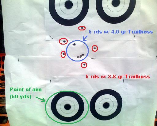

    Kinda surprised by the elevation, but I like the 4.0 gr Trailboss load behind .323" 120gr cast heeled
