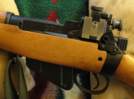

    Last time I took this rifle out, it was throwing shots all over the landscape and then started stringing vertically---which indicated to me that the damned thing was either disintegrating in my hands or demon possessed.
    I was wrong on both counts.
    1.It doesn't like PPU boattails.
    2.The handguard was riding the front sight block.
    I did some serious front band staking to fix the handguard and took it out to the range again today.
    After running some very aggravating "groups" with the PPU, I ran one last string with the FNB 86 and it's odd Frenchicon pattern bullet. Two elevation and one windage correction got the 100yard target pictured here.
    Photos of the expensive and complicated Schattenbaum Accurizing System to follow later.

    MCB---the rifle has about 400 rounds through it and has done very well in the past, when I had tubs of the 1980 dated South African ball.
    Brian---I save the .311 Matchkings for the Finnishicon Mosins, which can do something with them and have been reloading with FB bullets when I can find the time. I wish PPU would get off the boattail kick, I really do.
    Now more photos! Including the Fabulous Schattenbaum Accurizing System's secret stuff, wow!
    The muzzle end showing the Lyman No.17 tunnel sight and the solid sight base I adapted to take it. The sight protector was pinging the tunnel a bit, so off it came.
    Next the King Kong staking job that immobilized the front band.
    Leftside view of the rifle.
    Schattenbaum Accurizing System. From the Manual: 1.Loosen forestock screws. 2.Insert cork pad under barrel at the front band. 3.Tighten screws.
    -----krinko

    A loose fore stock will cause the Enfield Rifleicon to string is shots vertically, a loose butt stock will cause horizontal shot stringing.
    I would strongly suggest to anyone who is having a problem with stringing their shots vertically with the Enfield rifle to temporarily to remove the front trigger guard bushing and retest the rifle for grouping.
    If your grouping improve you have wood shrinkage and your bushing is too long and should be shortened. Placing cork under the the barrel at the fore end tip will not fix the problem and it will only cause damage to the forward draws area of the fore stock.
    Please note you have been warned before NOT to remove a snug fitting fore stock by wiggling the fore end tip up and down because it will damage the forward draws area and make the fore stock a looser fit due to wood crush.
    Also the standard practice of placing shims under the hand guards will keep them from from shifting fore and aft during firing.
    The reason I supplied 95% of the Enfield manuals you see on the Internet today was in the hopes of starting an Enfield Renaissance by increasing everyones knowledge. If we are to leave the "Dark Ages" and start a second Enfield Renaissance it would help to read these manuals.
    Up pressure at the fore end tip controls grouping and vertical stringing and cork at the front of the stock will not fix a problem at the rear of the stock.

    "...and No5."
    MCB,
    It has been my experience that the No5 forestock can be bearing on the left side of the barrel in the morning and bearing on the right side of the barrel by dusk---slippery little creatures that they are.
    A cork pad from the Schattenbaum System will keep wood to metal bearing in stasis, which makes it's effect on each shot repeatable, which is the soul of accuracy.
    "No tricks! No unpleasant bending!"---V.Stanshall "Mr. Apollo".
    Photo is such a pad installed on my beautiful 4/45 Fazakerley, which shoots nice round groups.
    -----krinko
