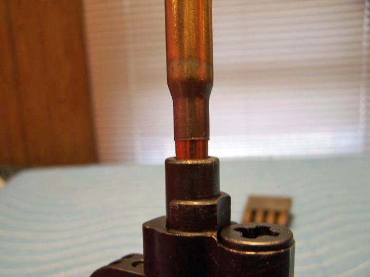

    Searched like mad on the forum but can't find the info....Can someone put up a link or the info.....Thanks Charlie

    If you put a 30-06 ball cartridge in the end of your barrel, depending on how much of the bullet is showing will tell approximate muzzle wear. Ideal is 3/16" or better of the bullet showing between the casing and the end of the barrel.

    The way I was always taught, and the way they explain it at the south store, is you must use "ball M2" cartridge because of the shape and olgive of the bullet.
    This may all be wrong, someone else can chime in here. please

    Correct, it should be a GI m2 ball round, not a commercial. On Ball M2, it is approximately 1ME per1/16". 1/16" showing is a 3, 2/16 (1/8") is about 2 ME, 3/16 showing is about a 1 ME, 4/16 (1/4") is about a 0. This info was from a CMPicon sticky awhile back.

    Thanks I have 1/16" showing.....Charlie

    About a 3 ME. I have had carbines with a 3 ME. Still capable of decent shooting. You can have it counter bored, also, to improve group. I would hang it as per CMPicon instructions and try it. You may be surprised.
