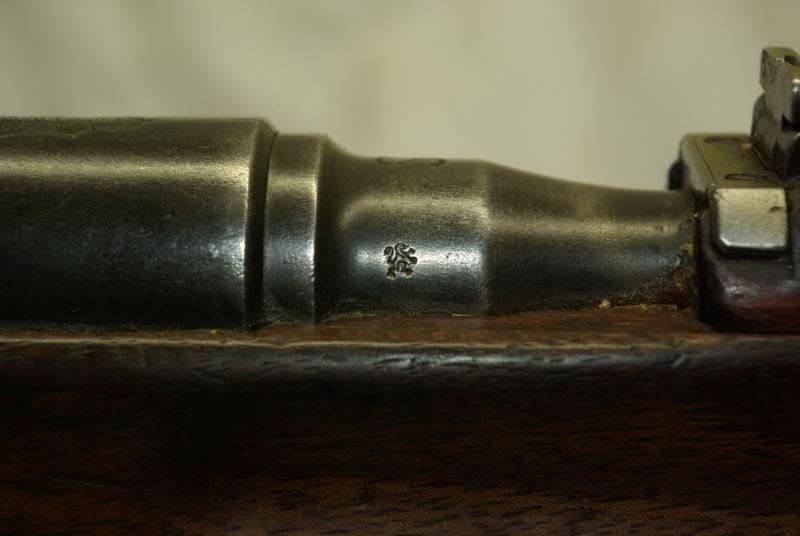

    so i finally got around to stripping the timber off the metal work. It was greased up to hell
    But i'm glad it was. when i finally got her cleaned up, most of the metalwork has been well protected. and a whole lot of stampings were revealed beneath the barrel:
    and also in the timber:
    in the one above "45" and "20" are stamped into the timber above the rear bedding pillar.
    anyone know what any of these markings signify?

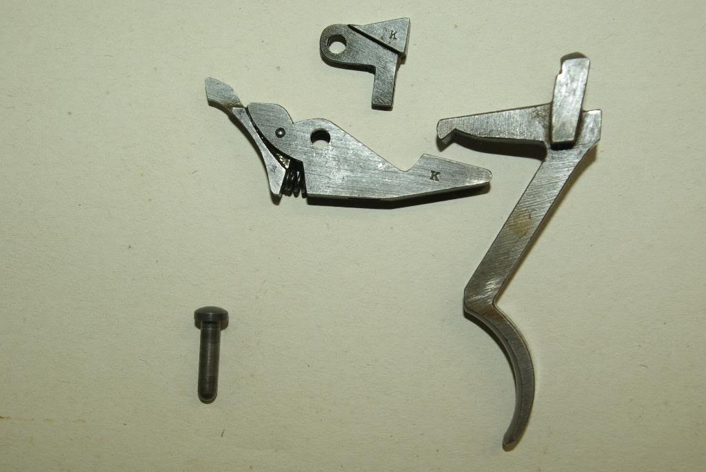

    above; trigger assembly

    Doubtless you are aware that these were built in Austria-Hungary and that the original callibre was 8x50R. The Hungarians, Austrians and Bulgarians modded them in the early 1930s for the 8x56R, which used a longer, slightly-fatter casing.
    Ammunition today is manufactured as loaded rounds by Prvi Partizan in Serbia. TradeEx in Montreal HAS Boxer-primed brass in stock as well as the bullets and Hornady now lists the pointed 208-grain bullet for these as well.
    I got one of these when I still was in high-school, paid $12 for it at Ed Page's Hardware Store in Hargrave, Manitoba (population approaching 75 at that time). It was represented as a "straight-pull Mauser" which it actually is in many ways. Bolt on mine is mismatched. As you have observed, machine work, fit, finish all are wonderful. Now that you have a third of a barrel of grease out of her innards, you will also realise how wonderfully LIGHT this rifle is for its length and bulk; a good pound less than other full-length rifles of the period.
